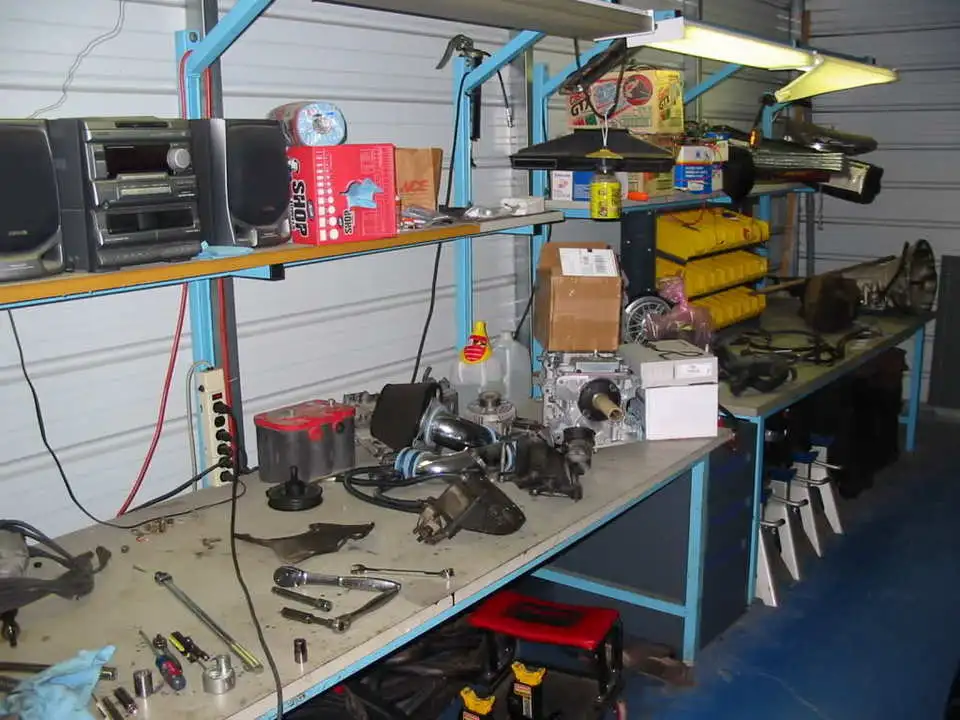

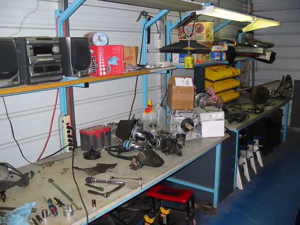

My shop is a wreck. Half of it is parts waiting to go on the car.

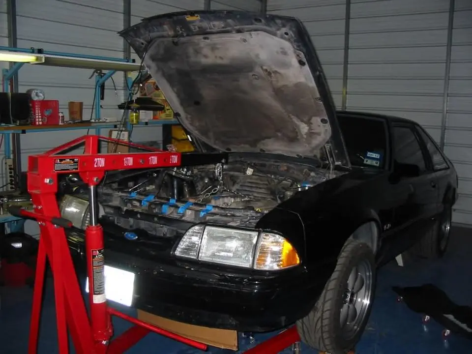

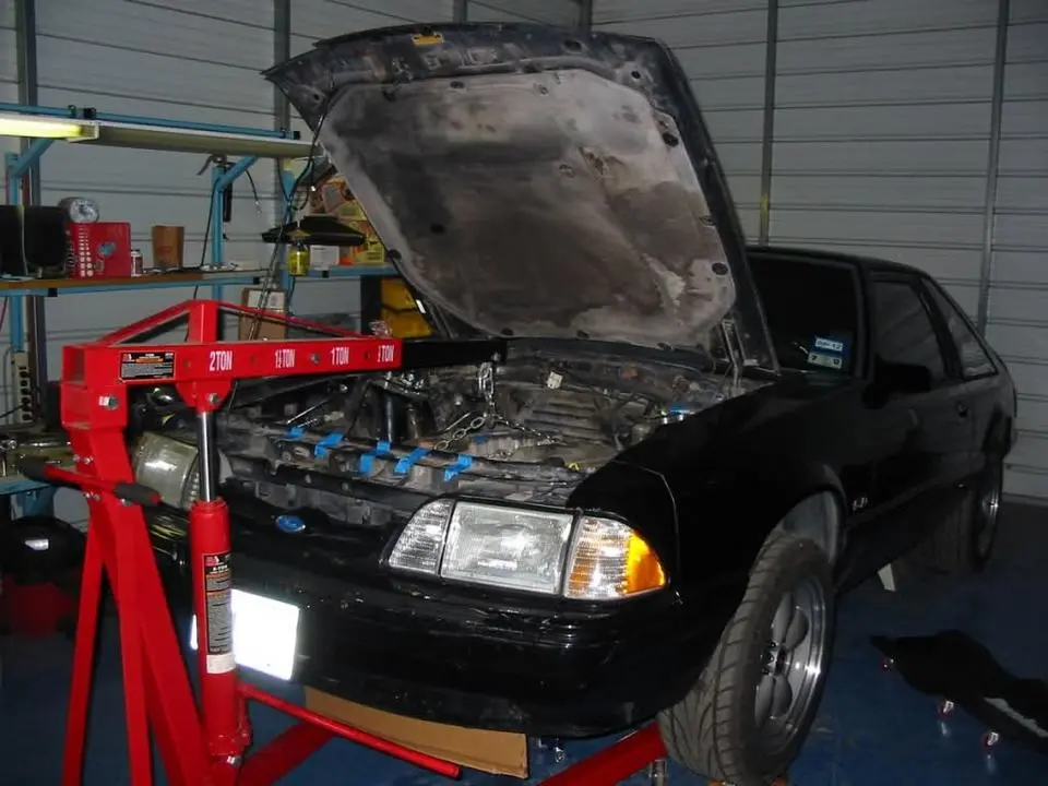

Getting there:

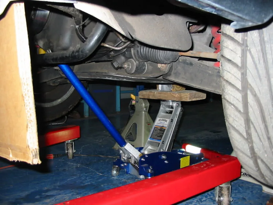

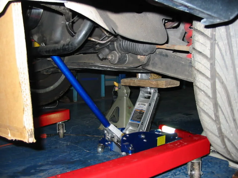

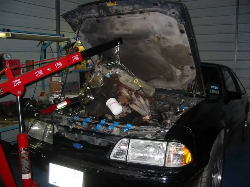

The things you have to do to pull and engine by yourself.

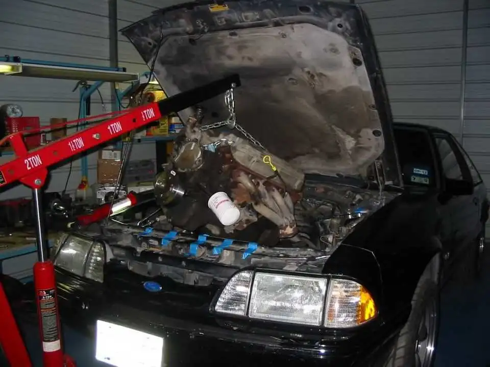

Almost out.

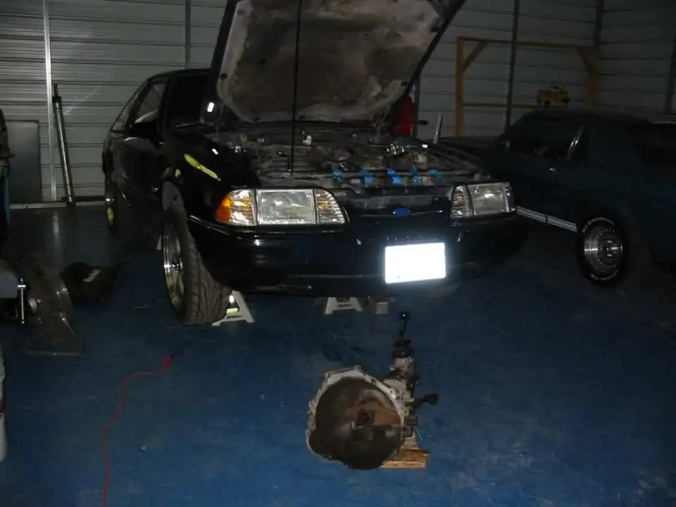

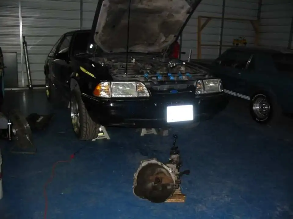

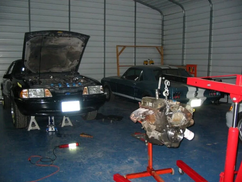

Finally. Note, it helps to remember the two lower block plate bolts when trying to separate an engine from a T5, rather then yanking around on it for 20 minutes like a jerkarse wondering wtf is going on.

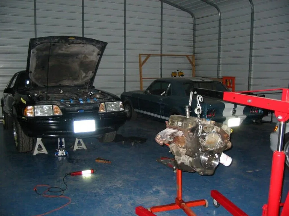

Getting the trans out took like 10 minutes.
Now I get to start cleaning. Also ran over on the miles for my WRX. So now I gotta go change the oil on it. Then I can shower and relax before work tomorrow.
