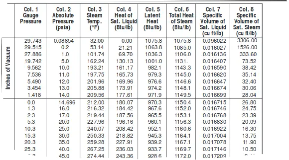

No, as in an air bubble in the cooling system is finding it's way to your temp sensor. It just so happens that steam is 212*F. :chin
Reactions: Davedacarpainter
I had this thought too . I had it running yesterday for a bit cap off. I topped off the coolant in the rad it didnt take much either. Ill start there and see what happens.
