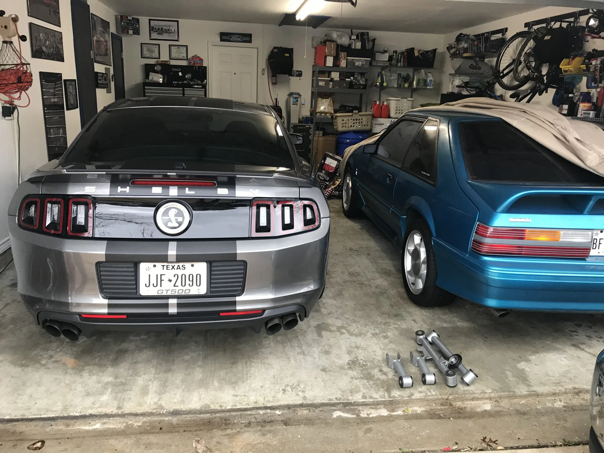

Seen some how to vids etc. What is the level of difficulty for this install? I have no experience but could maybe probably figure it out and do with extended time. I’m usually the guy who orders parts in and pays someone to install for me. I can tinker with certain things but full installs eh idk. Now I got the tools and torque wrench etc, but is this something say a beginners level 1 guy can do? Thanks, just tryin to be able to do more with my own car.

Pull bolts out. Put bolts back in.
Jack stands and a good floor jack. Take your time and disassemble just one side at a time.
A good (set of) pry bar(s) can be handy to have around but you will hopefully not need them at all.
Have you already inspected your torque boxes? Can you post up quality pics of them?

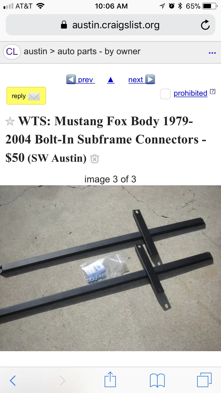

I don’t have subframes but also looking into that saw some on Craig’s but wasn’t sure if the 50 bucks was worth that or if I should wait and get better quality plus he said they were SMR and never heard of that company.
Bolt in SFC's are a no no
You want weld-in SFC's

Reddevil91 said:
Gotcha then I’ll let those slide and look for some weld ins
Some subframes are sold as bolt in which is useless. So buy those $50 ones and weld them in. They weld in and the cross brace supports the seat bolts which normally tear or rip your floor pan out. With these your car will be solid, zero flex and you won't wreck your floor pan banging gears. Any subframe is better then none.
As far as upgrading your control arms.. yes it's simply eight bolts and nuts but it's suspension and if it's original then it's gonna be a real pita. The bolts seize up to the metal they slide thru in the rubber bushings. This makes it almost impossible to get them out in one piece. Thus requiring new bolts/nuts being ordered and you wasting your time cutting/air hammering etc these bolts out.
So you think that those would be ok bc if they would do the job then I’m game and I’d just get them welded in as you say. As far as getting new nuts and bolts where is the best place or option to get replacements?
Correction: Not 'totally' useless
They are good for bolting into place before being welded.
This is a money saver if you bolt them on yourself then have to jot on down to the muffler shop to have someone toss a bead of weld down the sides. Just make sure that weight is on wheels when they are welded.
Those bolt in subframes could be welded in but they are missing the metal tabs that weld to the cars pan.
Notice the metal tabs on these MM sfc's below. This increases the area for welding which increases strength. They're not that expensive, it's worth passing up the craigslist ad IMO.

The $50 ones are weld in. I have them on my coupe. I have the maximum motorsport ones shown above on my convertible. The ones for $50 are wayyyyyyyyyy easier to install, and I can't tell the difference between my two cars. I doubt on a street car the difference between the two could ever be felt. I would buy the $50 ones and have them welded in.
