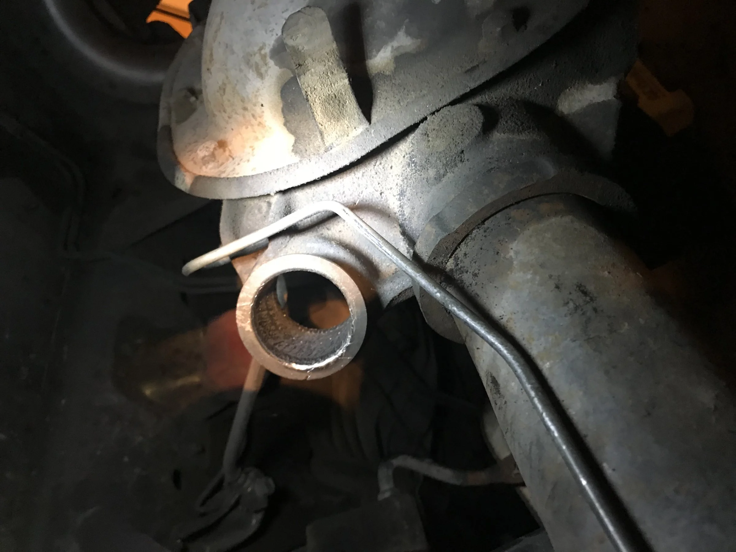

Nope just the axle bushings where the upper control arms connects. I have the prothane kit which is just the bushings that need to be inserted after you get the old ones out of the sleeve. I posted the ford performance one to see if you all thought these were better since there was a post about using stock rear axle bushings.

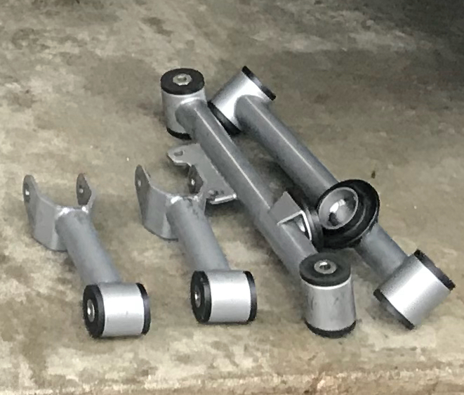

I’m using the UPRs for now and later would like to upgrade to a full MM suspension, but that would be later down the line, but picked these up for the time being, in great shape not bad for 125. As for the rear axle I am putting the prothane bushings But seems like those are gonna be a pain to get out. I’ve read to use the MM tool, air chisel, and even just drill thilm out with a drill bit.
w
if it were me, I would install a set of MM rear lower control arms and a set of stock 94-95 rear uppers, but hard to beat the $125 for what you bought.. make sure you use the proper grease and dont torque the bolts down until you have the suspension loaded at ride hieight

Ha I do want MM but at a later point. I found these for cheap and really clean. Right now focus is on motor, then paint, then suspension. For now I figure these have to be better than stock. Now does every bolt need to be torqued to specs after full load bc idk how I’m going to get in there for all of that. The vids I watched seems like everyone tightened and then torqued to spec the easiest bolts to get to on the lowers.

I've ran those same moly upr control arms on my daily fox for a few years now. Car sees allot of abuse and haven't had any binding issues with the poly mounts. Replacing the upper to axle bushings was a pita though, I didn't use the drill method I ended up burning them out.

I've ran those same moly upr control arms on my daily fox for a few years now. Car sees allot of abuse and haven't had any binding issues with the poly mounts. Replacing the upper to axle bushings was a pita though, I didn't use the drill method I ended up burning them out.[/QUOTE
Ha I am trying the drill method but I’ve snapped like 3 drill bits thus far

I highly recommend not installing poly bushings in the rearend ears. If you are wanting to replace those bushing just spend a little more money and put in spherical bushings.
Adding poly bushings just add to the binding of the suspension when you are wanting the opposite.

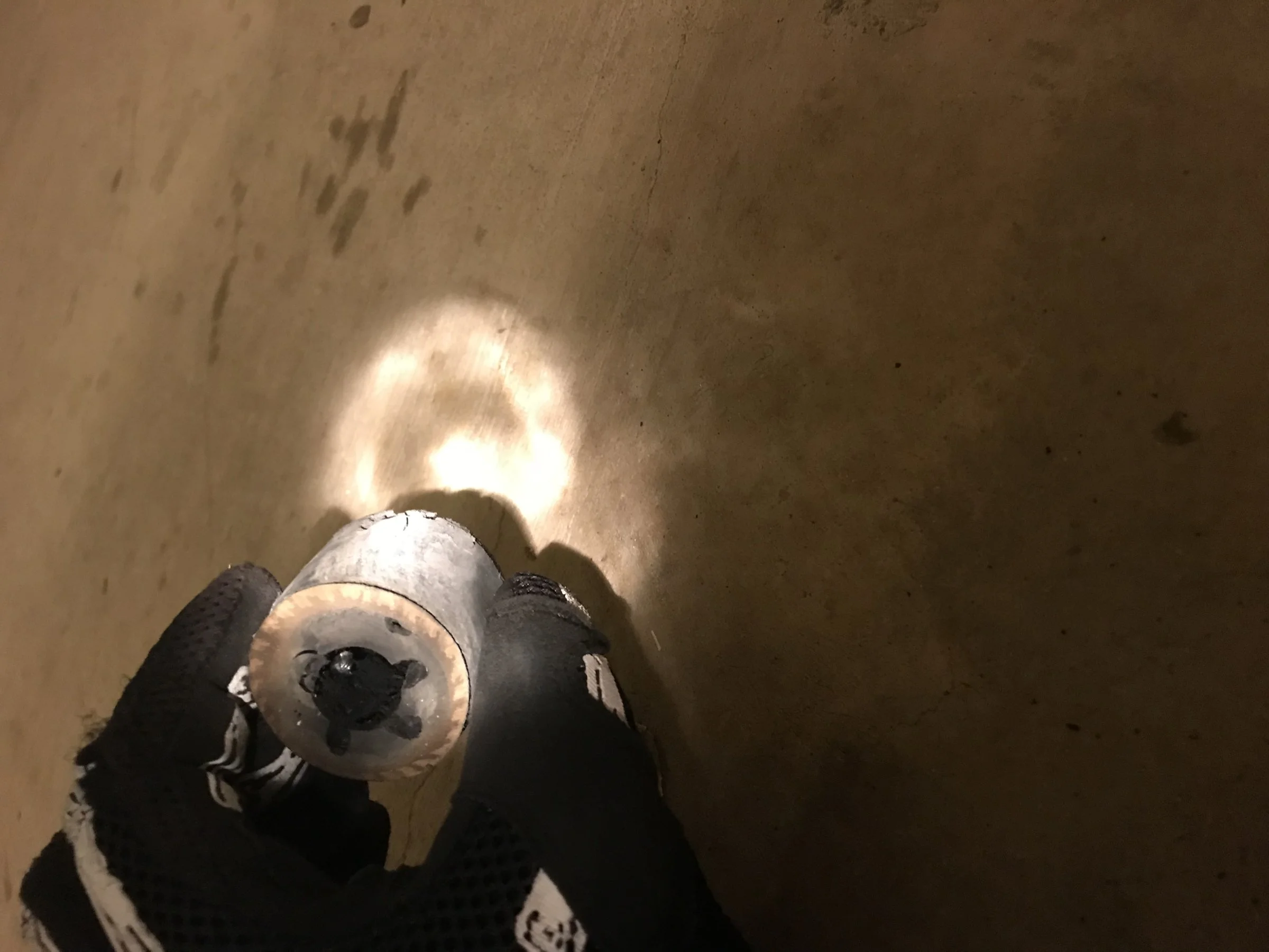

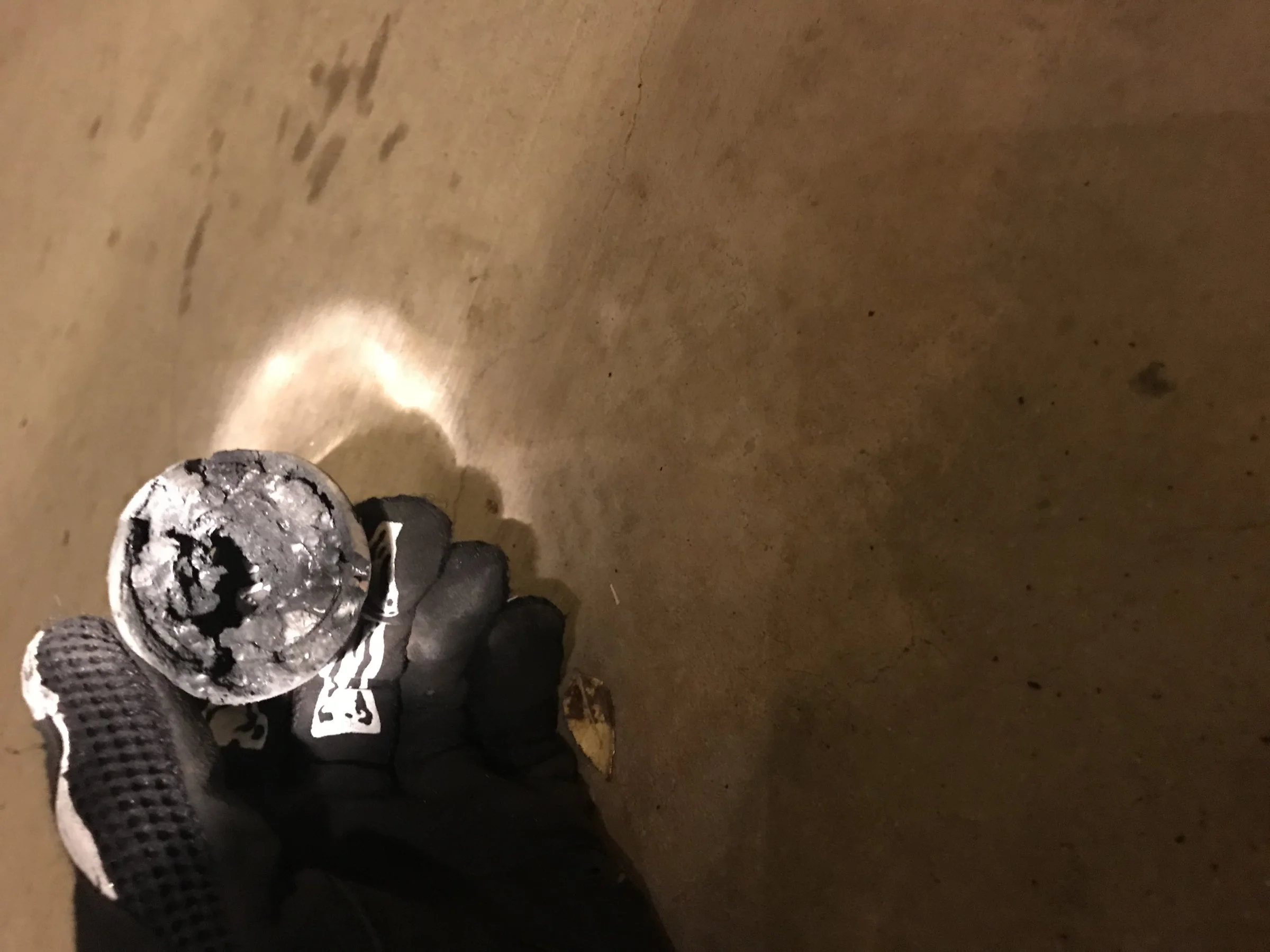

Well finally got one side out, people weren’t lying when they said it was a pita to get these bushings out!!
Reactions: stanglx2002, Shakerhood and Davedacarpainter

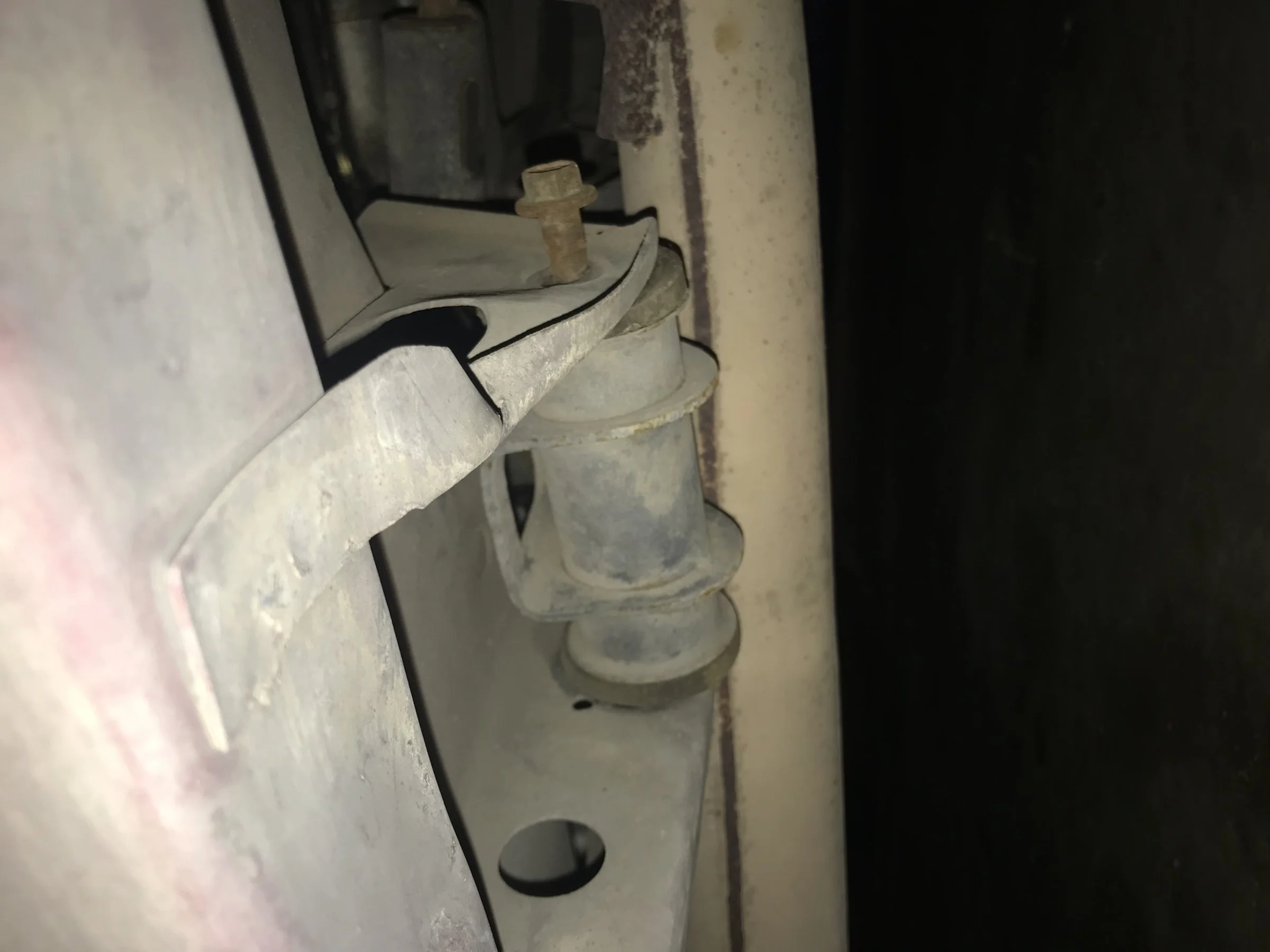

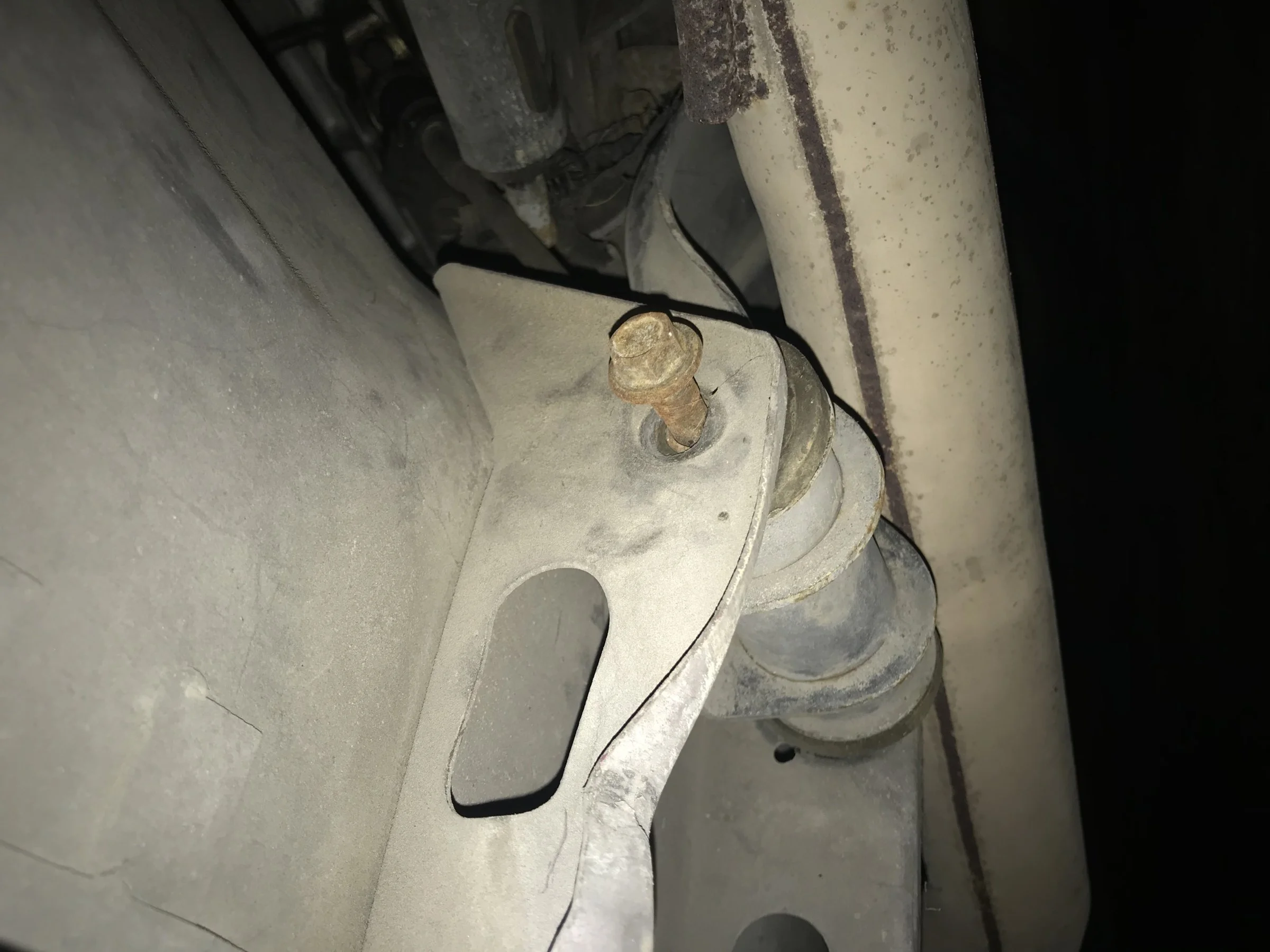

So last night I noticed this on the crossmember, not sure if the bolt just got loose or how long it’s been that way. Also how many of you all swapped your sway bars out and are they an investment that’s worth while. Was wondering if i should swap my rear one out while I have it out or am I ok on saving money and passing on this?
