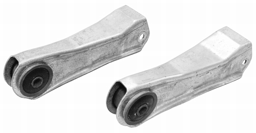

Stock UCA part# M-5500-A
MM Adjustable LCA
