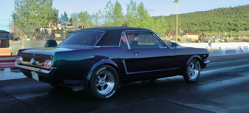

Handling is not that bad at all. I have the mopar spring relocation, with about 2in of metal removed to the frame, and the wheel tubs moved in 2in as well. I have 1inch lowering calvert springs and a 7/8inch drop block with 275/50/15's M/T drag radials. So about 11in or so of tread. I dont drive in the rain, but i have never had any issue with handling, water, ect. if you want any more info, let me know. You can also look at my pics in my sig.

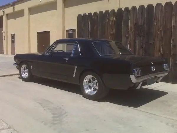

After I put the 3 link in I was able to get 275s to fit much better to the point that I could drive them on the street if I wanted to. I have a little uneven car (my one wheel well is wider by almost an inch than the other and the rear wasn't quite centered. With the 3 link I was able to center it and I beat the smaller wheel well into submission on the inside to keep it from rubbing ;) )

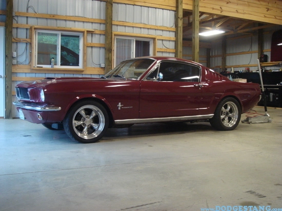

Wish mine was done so I could tell you. I did what Wicked65 did; I also did the 67 outer wheel wells. I got a pretty big tire in there. I am almost ready to paint, but out of the next 4 weekends I'll be gone 2, then out of town for 6 weeks. Once I get it painted I'll post some pics.

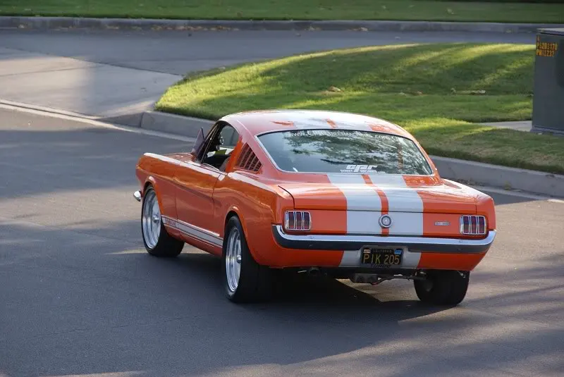

heres mine and they BARELY stick out, they will tuck if let the air suspnesion down.lowered leafs and massaged front corner of wheel house
