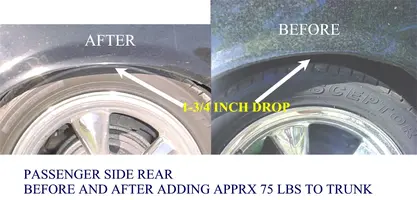

But here is the question.... a couple weeks ago I had a sub-woofer installed in the trunk. They went a lot further and upholstered the entire inside of the trunk. It's unbelieavable how good the inside looks but apparantly they added about 50 lbs of weight to the trunk and now i am back to were i was befor the spring change. Actually i noticed an increasing problem over the past couple months. I looked under the car and the springs are completely flat with no one even in the car and no luggage, groceries etc. Shouldn't heavy duty springs still have some arch and not be flat? Could these springs be defective?

Thanks i will look into that, of course that means having to spend $300 on new wheels. But i am still way too low in the rear end. I mean it is really sitting low. Would you think the springs are shot if they are flattened out with just 100 lbs on the car? When i first put the new springs on i had 1 inch cleaarance between tire and fender well. Now with 100 lbs in the trunk it is 1 inch below top of tire. In otherwords dropped 2 inches. And should not springs still have some arch? These springs are under warranty.

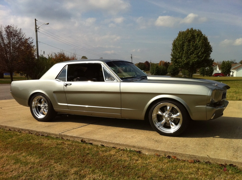

Heres a side shot of mine
By wildstang at 2011-10-27 . 17X8" wheel 245 tire. If you add blocks between the springs & rear end, it will lower the car even more. Can you post up a pic of the rear springs. Maybe we will be able to give you a better answer to your question afetr seeing the pics. Thanks

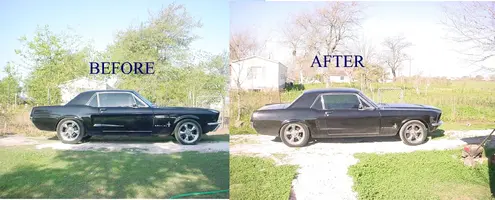

Here are a few pics. I have contacted Laurel mountain where i bought the springs and they said to send pics. Will see what comes of it. Even when i had just put the springs on I still did not have the load capability i wanted. The stance was perfect but still could not have 3 people in the car without problems.
