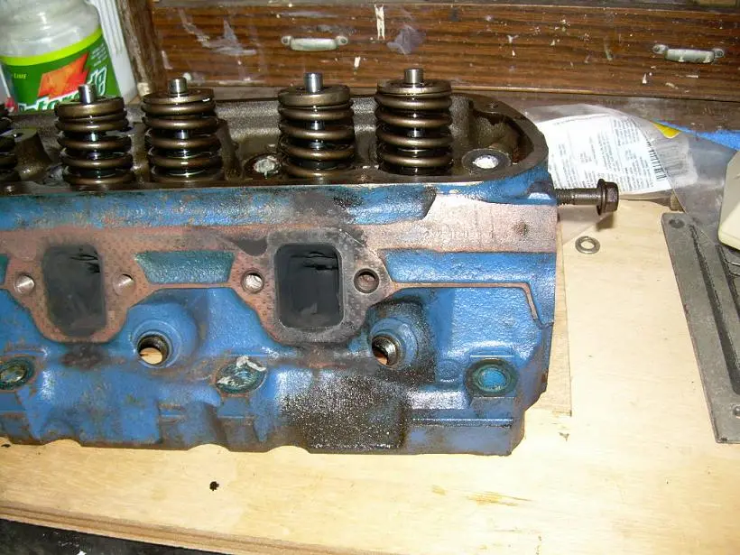

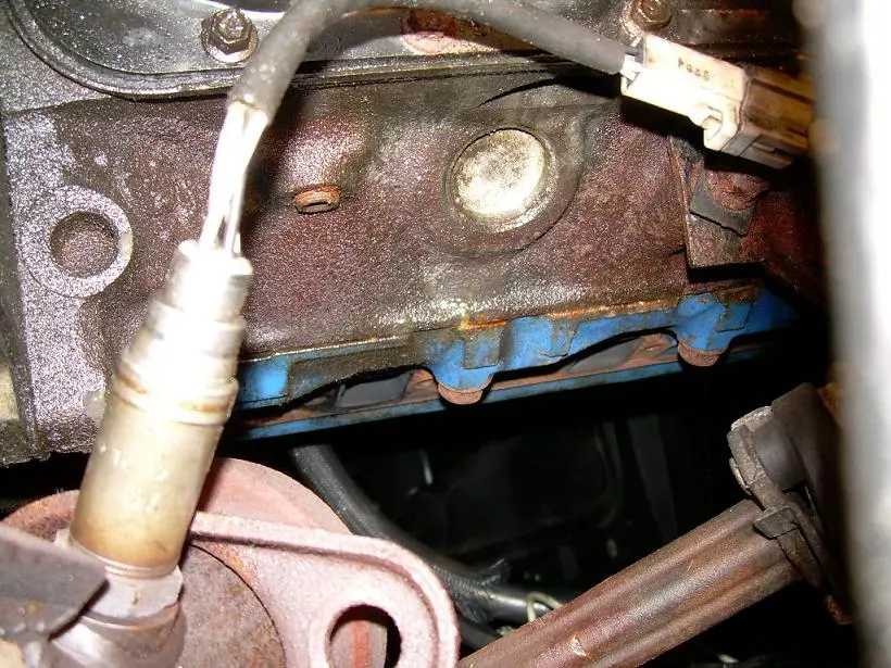

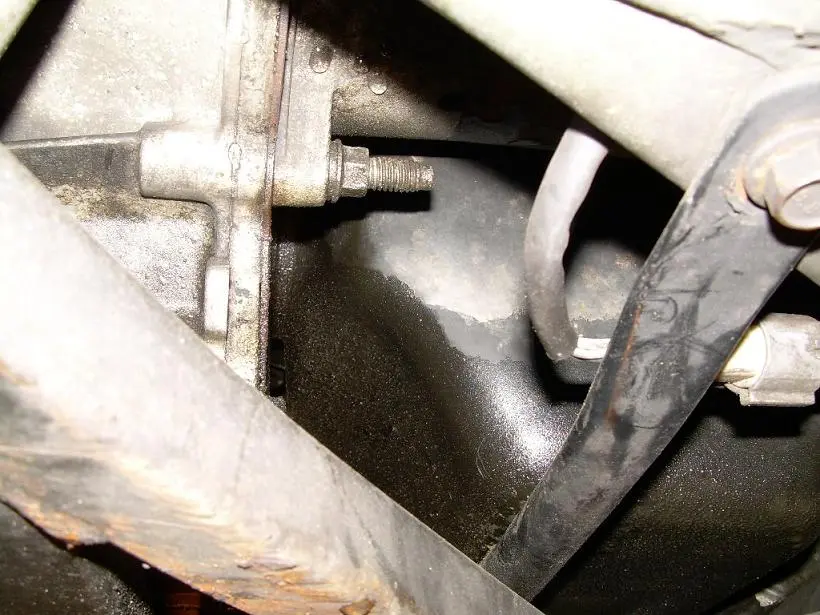

BlackVert said:
check the #8 spark plug hole
why?
BlackVert
Oct 3, 2003
5,589
9
98
Bethesda, MD
Nov 15, 2006
#20
  • Nov 15, 2006
  • #20
Guero said:
why?
on mine it was coming out there and running down the side of the block and all over
