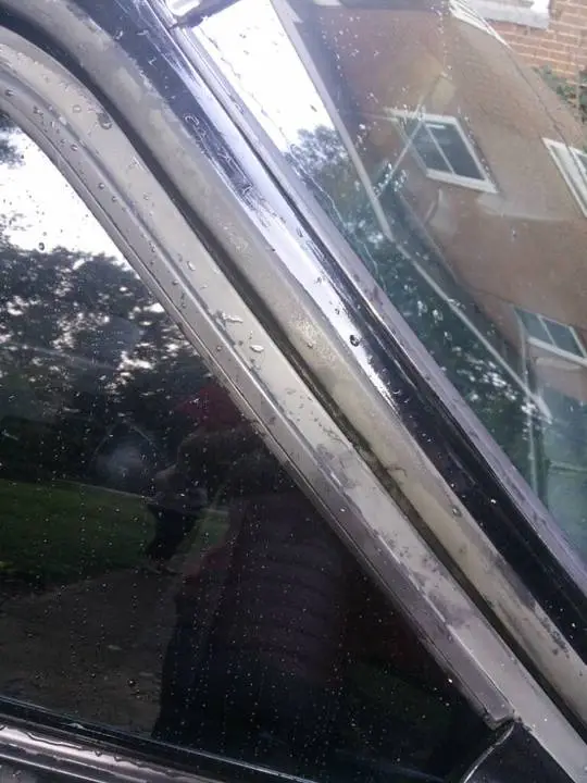

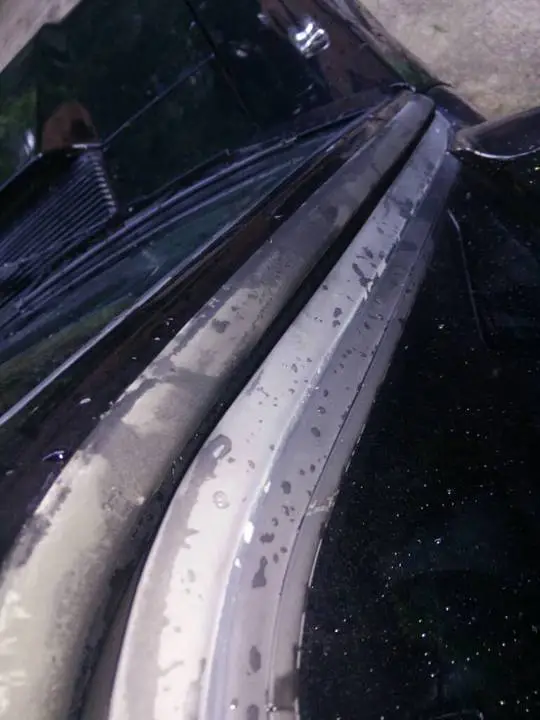

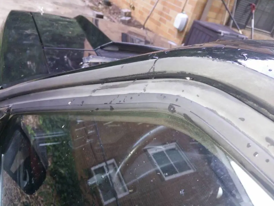

So I recently purchased a '90 hatch. The seals all look good but the passenger door leaks. It also doesn't appear to set in like the drivers door does. Ie there is a gap between the a-pillar and the door that doesn't exist on the drivers side. It let's a LOT of water in the car.
Suggestions to fix? Is this a weatherstrip issue or a body issue?
Pics of the door-
Sent from my OnePlus One using Tapatalk.

Looks like you may have a door hinge issue. When you open the door and grab the bottom can you lift the door up ? If you take the fender plastic out you can adjust that gap. The bolts holding the hinges to the body need to be loosened...a thick rag on top of a jack and an extra hand are needed.

That was my initial thoughts, but I couldn't feel the door lift when I opened it but I didn't try to lift from the bottom. I'll do that in the morning and see what happens.

Nah I sat in the car with water running on it today and physically saw where it was coming in thru the top of the door jamb around the weatherstrip.
