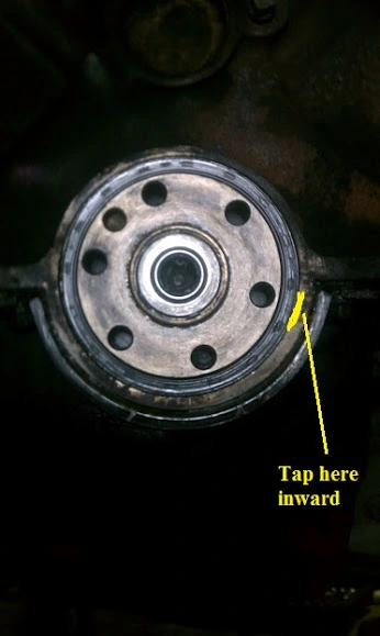

When you get to the rear main seal, just use your regular tools you have in your garage to get it out. I tried the screw method, and it laughed in my face. There is a much easier, and safer way (if you are patient). Take a flat head screwdriver, and bend the outside of the rear main seal towards the center. You have to be careful, and make sure you don't slip and hit the crank. Light careful taps will ensure this. When you do this, you will create a gap where you can up the end of the screwdriver between that, and the outer metal, and pry it out. This doesn't take much force at all, and it comes out with ease.
What I did to get the new one in, I used white lithium grease and coated the new seal. I then put it where it needed to go, and used the old seal to help guide it in. Instead of tapping the new seal, I tapped the old one, and used it as a protector and guide, if you know what I mean. This also made the seal sit all the way in.
