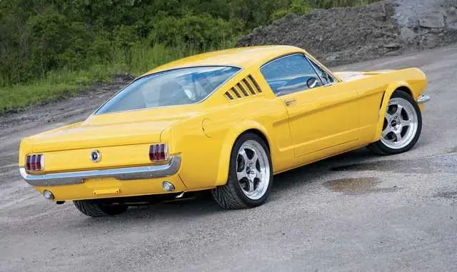

I got a strange question, has anyone ever seen a side mounted gas opening on an old stang. My dad was asking me what I thought about filling in the rear and doing some different taillights and doing the opening to the gas tank on the side. I guess how some new mustang do the billet aluminum.

I thought of mounting my gas cap on the rear pillar a little while back because i was going to mount a cell under the package tray. (ultimately decided against the cell, 16 gallons of gas weighing 100+ lbs would severly affect handling being mounted that high up) I did a few mock ups with different gas caps and it looked decent and unique. A billet fuel door on the quarter might not look bad either. You can run down to autozone and pickup a fake billet gas door sticker (made for those wanna be rice racers to stick on their stock door) and try it in various spots to see how it would look. There are only 2 problems you might run into moving the neck. 1. Where it is stock the neck and rubber connector are guarded by the trunk
latch mount. 2. You wont be able to just pull up to any pump you want and not have to worry about which side the filler is on (not major but i like it)
Also have you thought of below the rear window with a flip style cap? it would give it a european sort of look and still be unique.

I did see the SN65 did the side gas tank and its pretty seamless. They kept the rear the same though and kept the other gas tank entrance.... I am curious to see that filled in
I guess I should open photoshop and do some work...
