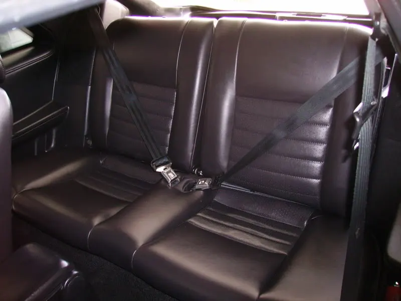

i dont think the 94 or 95 will fit with out mods...the mount ways are different but if you tack weld in the new mounts you could...since yours is a hatch you could use the newer leather seats....iwashmycar has them in his hatchand they look great...pm him about it he midifed his to fit but i dont have any pics on my comp.

the rear SN95 seats will bolt in just fine with just minor trimming an patience. now welding necessary. the mount points are essentially in the same spots for both cars.
I put 96 seats in my vert the front seats bolted in just fine(now I have seats that actually recline) and the back went in after about 2.5 hours of trial and error.
it's all something that you can easily accomplish with some patience a screwdriver and a box cutter. do a search, it has popped up quite a bit.
