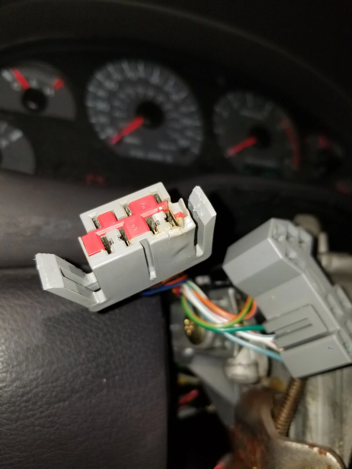

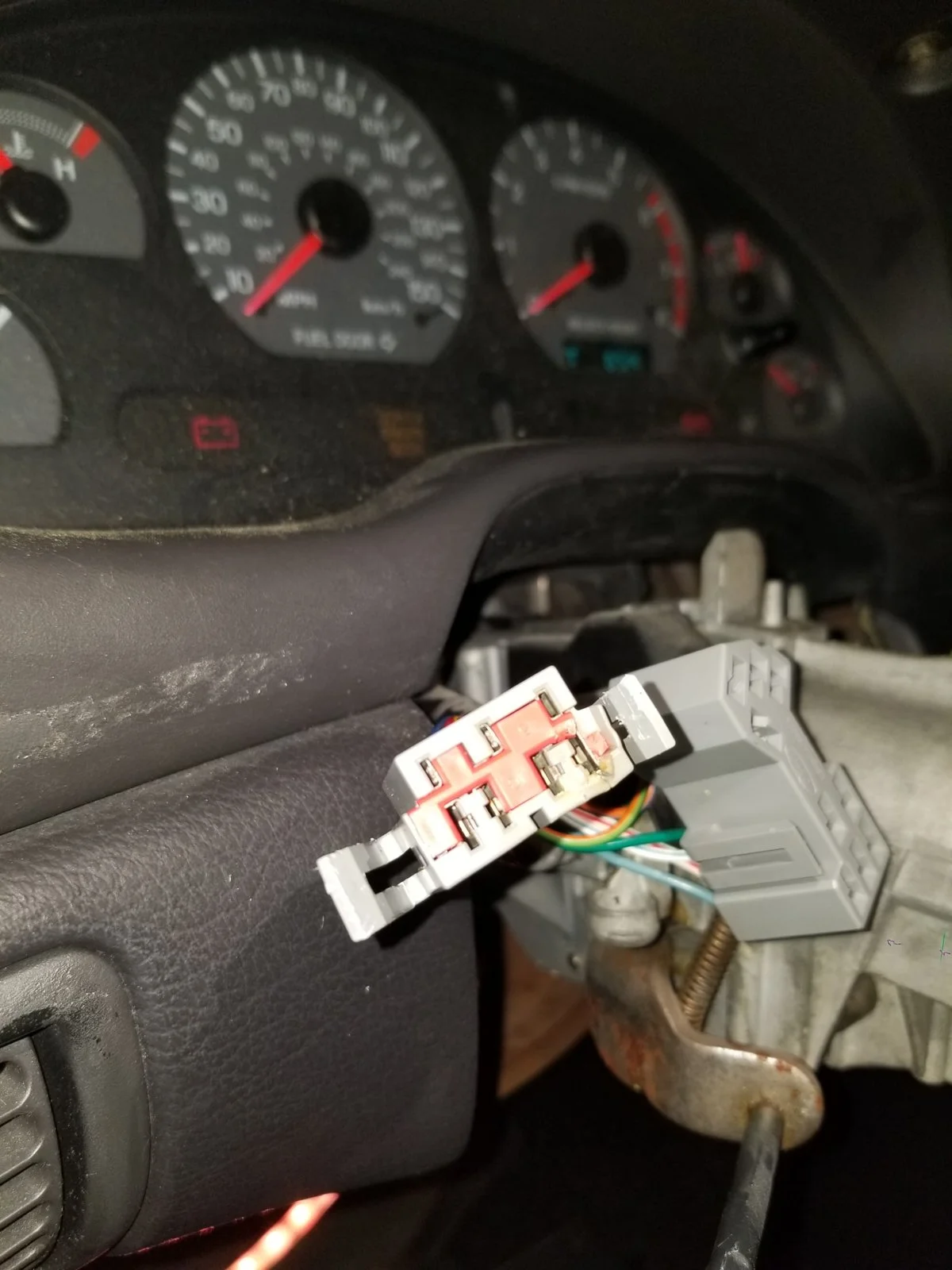

Took the turn switch off the steering column to check the wiring in the switch and the plug has damage. Will soon find out if that is the culprit.
Stuck once again. I unplug the driver front binker bulb and the interior dash light turns off. I plug it back in and it comes back. I have cleaned and tried to check wires with a multimeter and check fuses and i have found nothing yet. The plug is a little burnt but there is no crossed connections in the plug. The flasher switch works like it should and even when unplugged, the light stays on. Unplugged the flasher relay under the dash and no change. I have swapped both turn signal bulbs in the front and have found nothing new. What do i check next?
