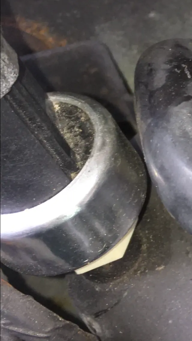

That may be a plastic piece to keep goop outta the spring lock area.

Yes it is leaking . That’s what a refrigerant leak looks like.

MrPerfect2 said:
What is this

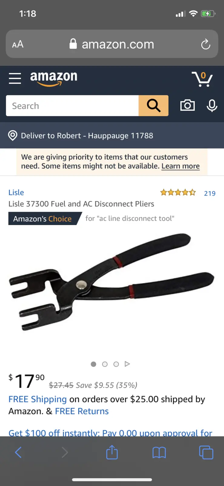

I think that was Fords “tool” they gave you to disconnect the lines. There’s probably one at each connection. With the right pliers, those tabs would push in, and disconnect the lines.

Yep - the white ring was to push in and squeeze the spring and allow to disconnect . But with a soap test did not see any bubbles here ( still heard hissing after I put a can in ) was getting ready to chalk it up as the coil in dash leak . As I was rinsing off the soap I saw the bubbles here on the clutch switch on canister . Grabbed a wrench and it was loose , tightened till no more hiss ! Will get a few more cans of 134a tmmrw and see - btw the Amazon radiator has been working great ( $80 )
