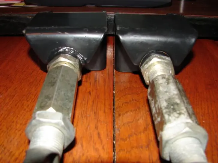

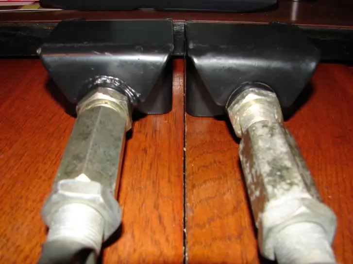

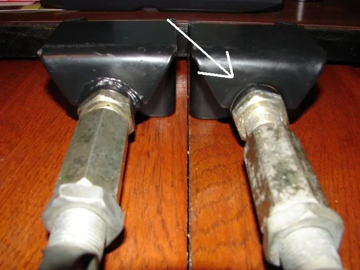

What's wrong with this picture? Hint! It is a Granatelli Upper Control Arm; high quality, USA made, precision suspension componet (yeah ok :lol:)
Give up?
It's missing a WELD. 2 points for you if you got it right :nice: (Crowd: yaaaaaaaaaaaaaaay) :)

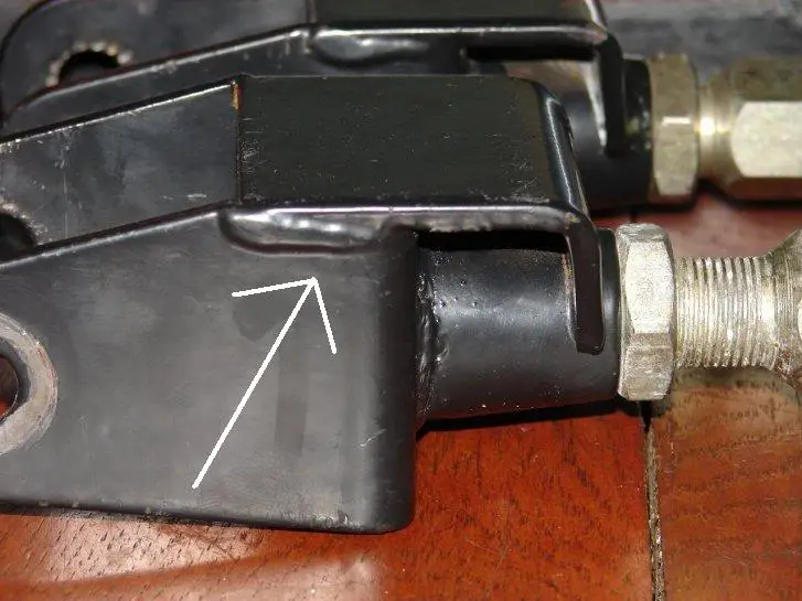

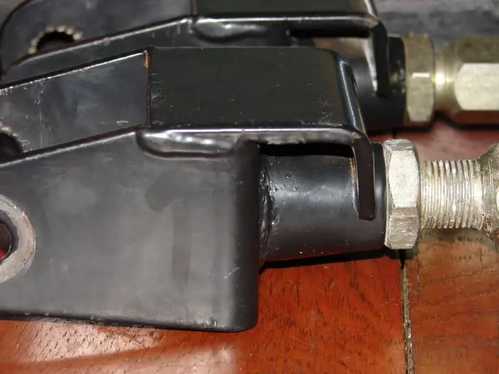

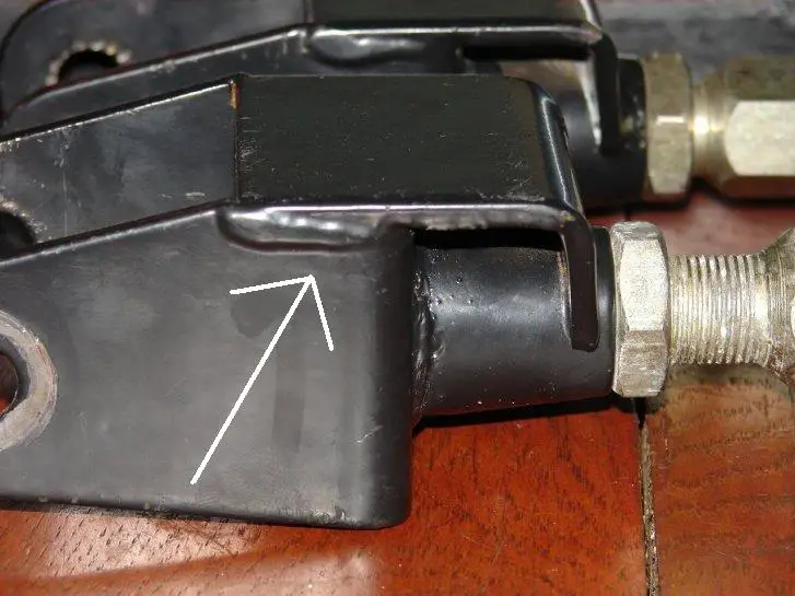

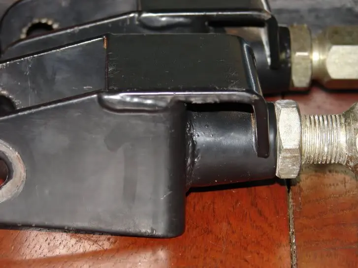

OK next question, What's wrong with this picture? Hint! Same Granatelli Upper Control Arm; high quality, USA made, precision suspension componet (I'm killing myself over here :lol:)
Give up?
The ****ing welder didn't lay the bead straight and wandered off and didn't connect the metal, also ALOT of spatter all over the place, I wouldn't doubt they used flux wire insted of Mig. I have to give some credit, they did deburr SOME of it ;)
Yes, I was looking thru some of my old GT boxes and found these laying around, and just wanted to add yet another QUALITY thread to the oh so famous granatelli name into the archives. Please stay away from his products and drive safe :)

I'm speechless. That just makes me scared for all those who are running components from them that have similar weld issues and don't even know it. Where there is one, there is always another.
not only the weld, but the metal quality and thickness aswell :notnice:
