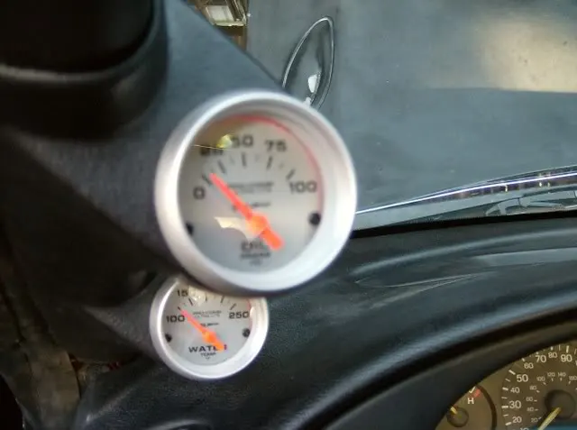

i talked to a guy w/ the electric water temp gauge, same as mine...the temp would just spike all of a sudden, go from 180-250+...he cracked #3 wall on a 351 b/c of it...
i noticed mine did not keep up with the stock sending unit using the tweecer to log temp... mine would show 160 when the ect showed 180... he bought a $20 mechanical water temp gauge from oreily's and said it works just fine...
im going to do a little research since i have all autometer and they SHOULD be the best...

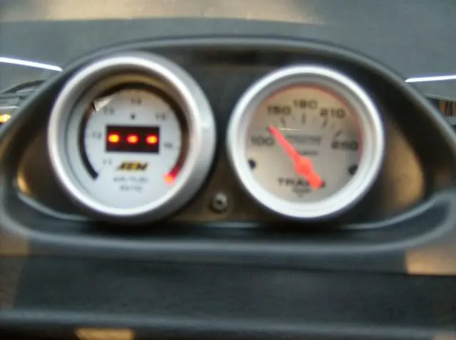

This is my old setup with Lunar guages.
The new setup as it is now, the clock pod will be going back in when i get the wideband installed.

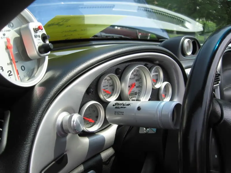

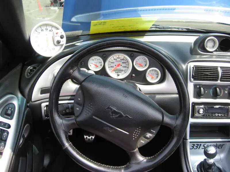

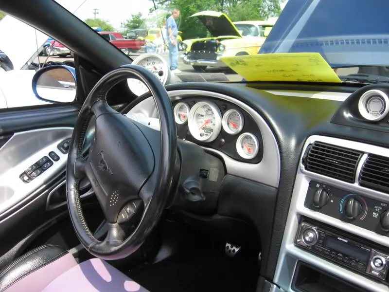

couple pics from Carlisle last year:
Troy's car (yeahloh95)
Paul's car (killercanary)

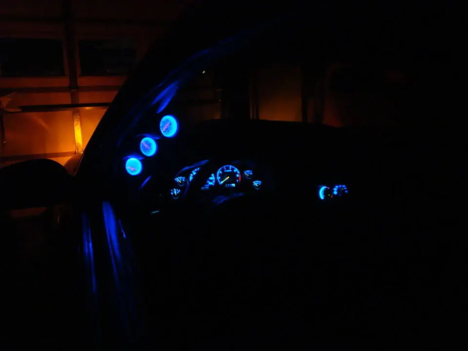

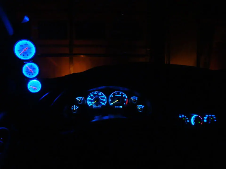

Here's mine with the blue l.e.d backlighting..
How does one do this???
Do you solder the LED's in were the orig. bulbs were or are the bulbs you just plug in?
VERY interesting...more so since most autometer lights suck unless you get the newer ones. pro comp/sport comps lighting is not so great.

haha.. NO..
I bought three blue l.e.d's for the autometers...
Then I bought 7 cool white leds for the cluster and hvac controls.
I bought them from superbrightleds.com and they just plug in just like the original lights did... Took an hour to do everything :)

do you remember which ones you used for the cluster? they have 4 different types. was it the first one listed? WLED-W
WLED Car Bulb specs
edit : i just realized the cool white only comes in the WLED-CW5 and WLED-CW6. are they the CW5?
WLED Car Bulb specs
Yes.. I used the CW5's for the cluster and the Blue 5 Led ones for the autometers...
The only downside is that they don't dim very much.. You can turn the dimmer all the way down and they're still pretty bright, but they look AMAZING at night and I'm very happy..
Cost like $43 total for all seven plus shipping
