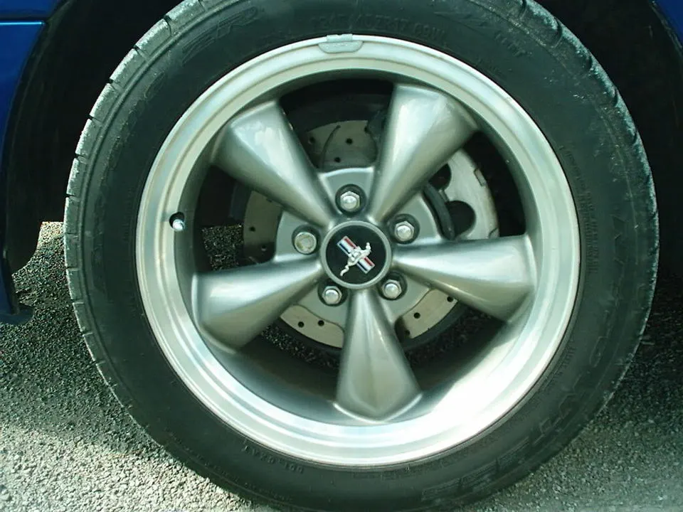

i too went with a budget brake upgrade. i got mine from ebay. a company named Gripforce. i was very pleased. they were drilled and slotted and also came zinc coated for rust resistance. very nice set. they used stock calipers ( which i repainted ). i spent the extra money and got Ford Motorcraft pads - minimal dust.
the rotors themselves i got for around $130 shipped, all 4. they also looked great behind my black wheels.
