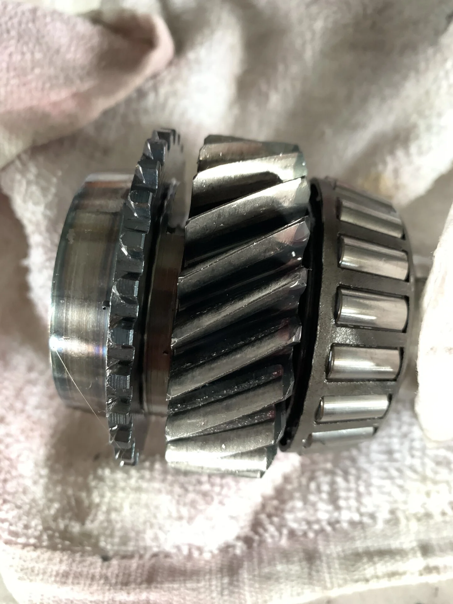

Well now both the input and cluster gear are AMP distributing. I'm installing the replacement cluster gear now. I made sure to press the new bearing on past the shaft like 90sickfox showed.
Here is the clearance between the case and the end of the cluster gear. Measured to be approx. 0.050 in
Pretty much exactly the same as the original cluster gear.
