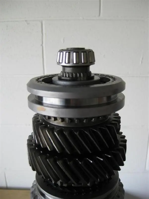

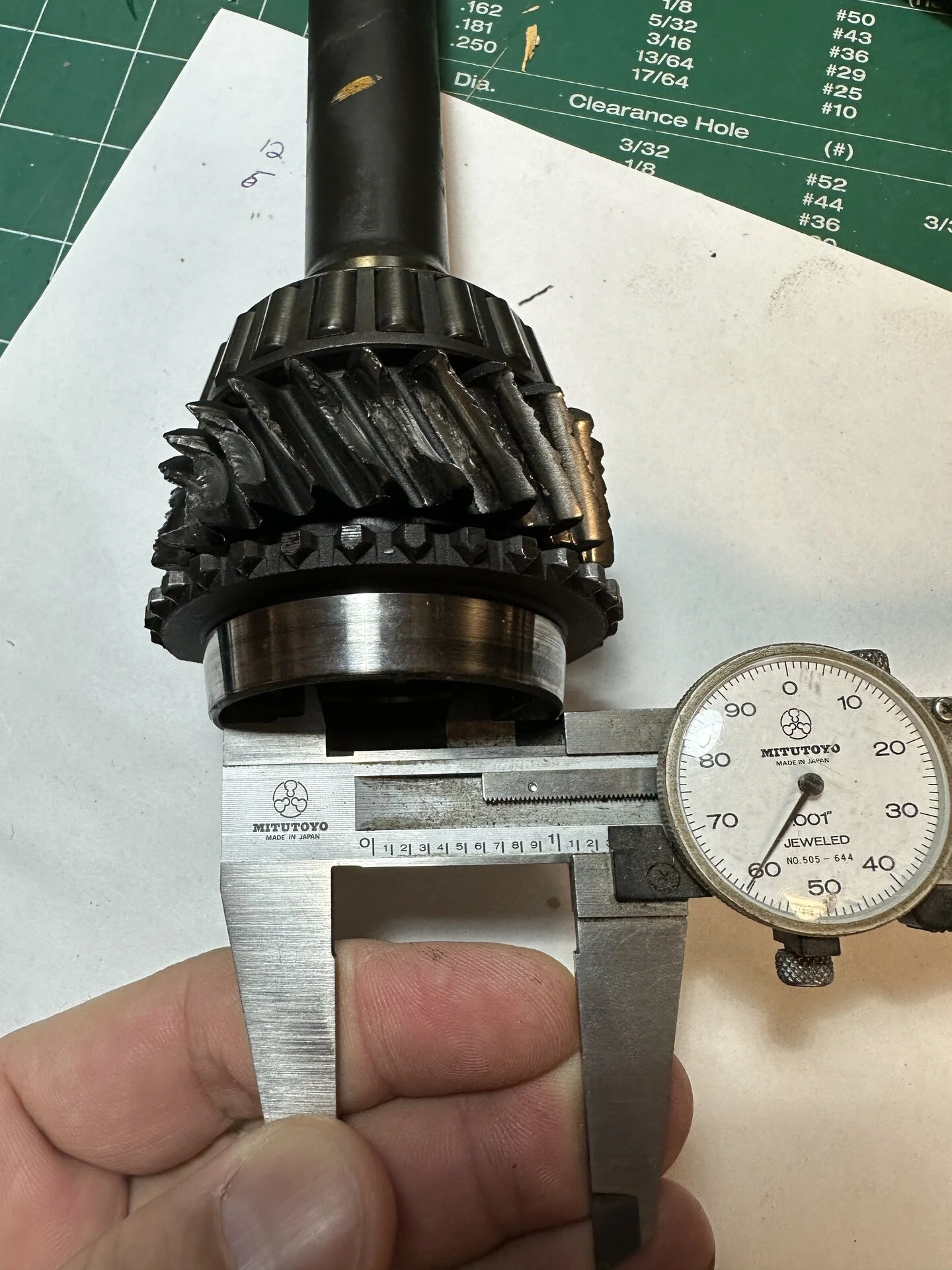

I remember shimming it last time. I think I set it until there was no more play and a very slight resistance. Ill check out the manual for the actual specs this time. Fortunately, I kept all of my shims, so I should be good there. If anyone has specs for the o.d. of the pocket bearing (the part on the input shaft), that would be great.

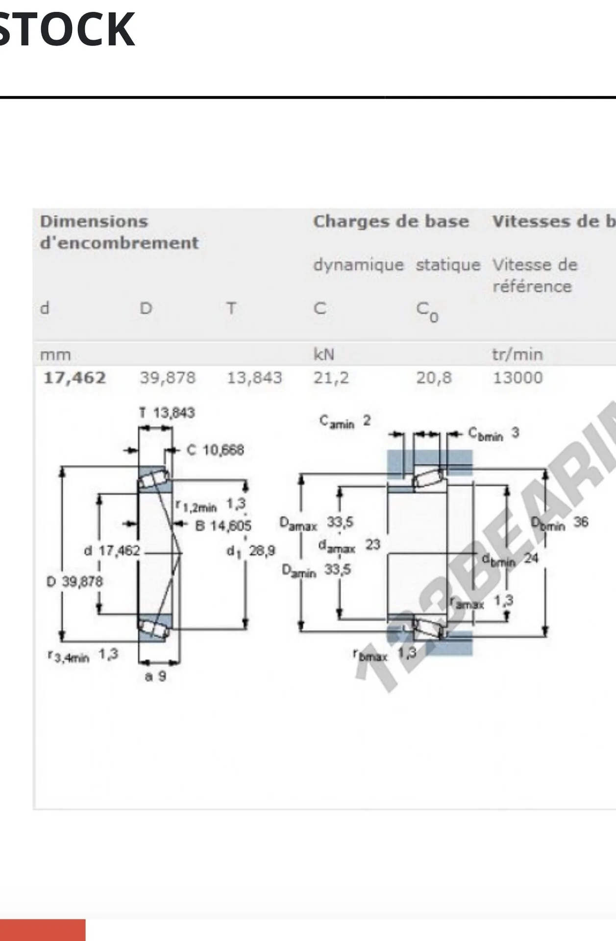

You referring to the 93 cobra style pocket bearing?
I’m 99% sure it’s an Timkin LM11749/LM11710 bearing and race setup. Shows up as 1.57” OD on the race but you’ll want to get one in hand to measure first. Pretty cheap, common bearing.

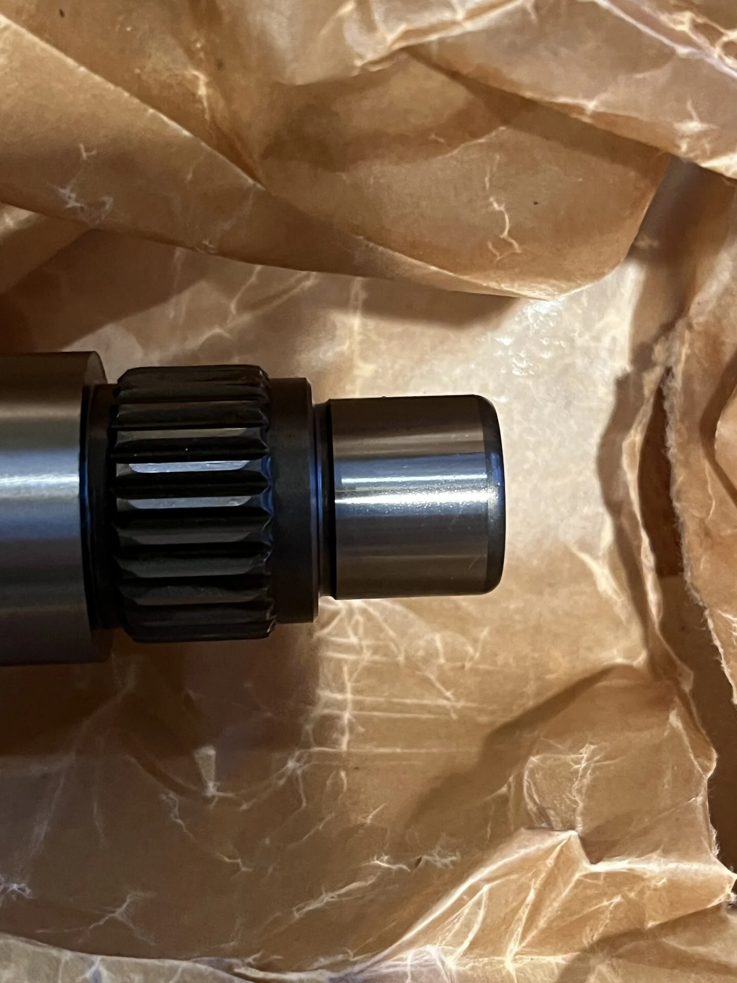

The input shaft and mainshaft are unique due to the bearing.

The bearing you need measured is the pocket bearing for the input shaft or the tip of the main shaft where the roller bearings go.

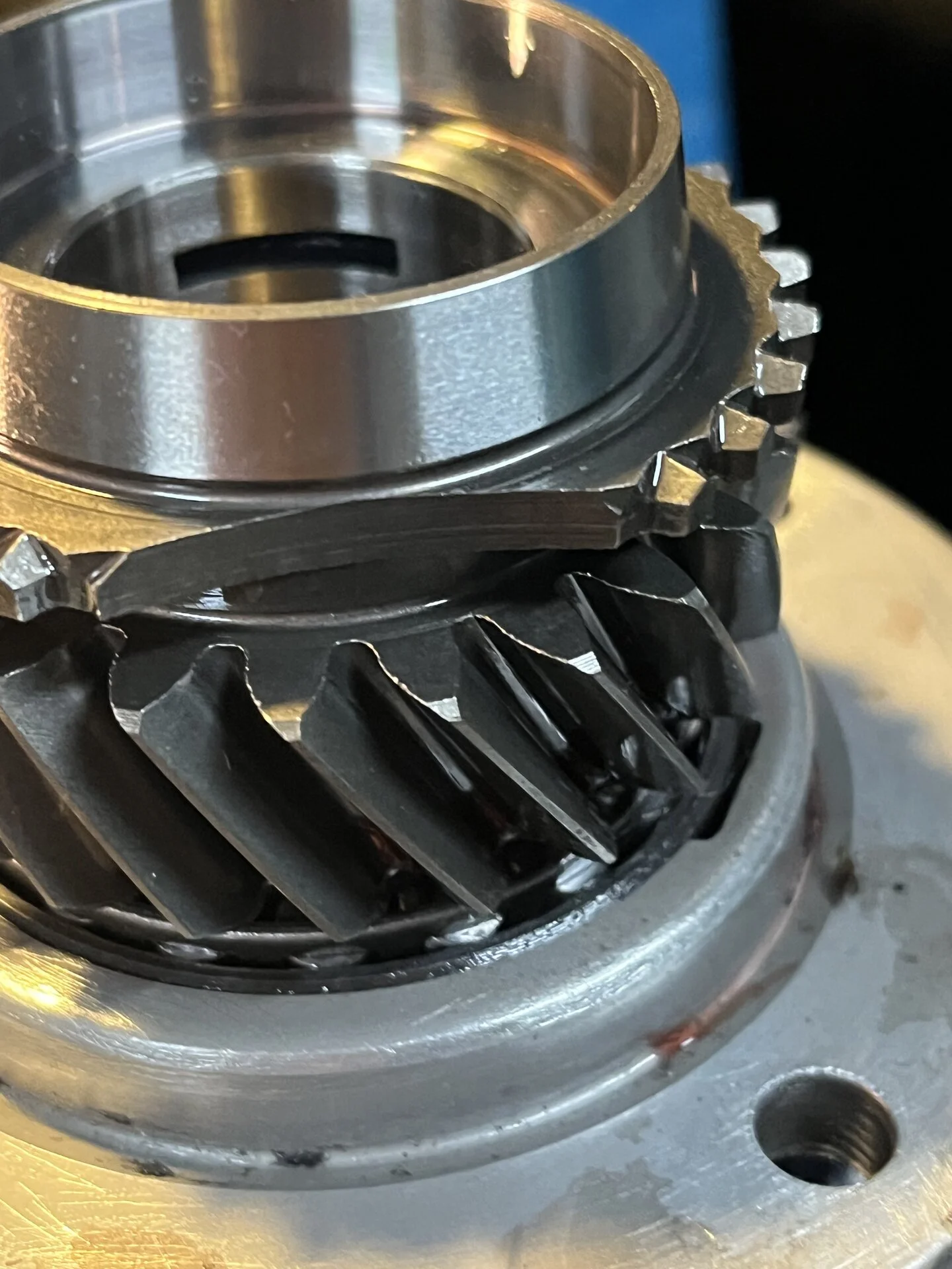

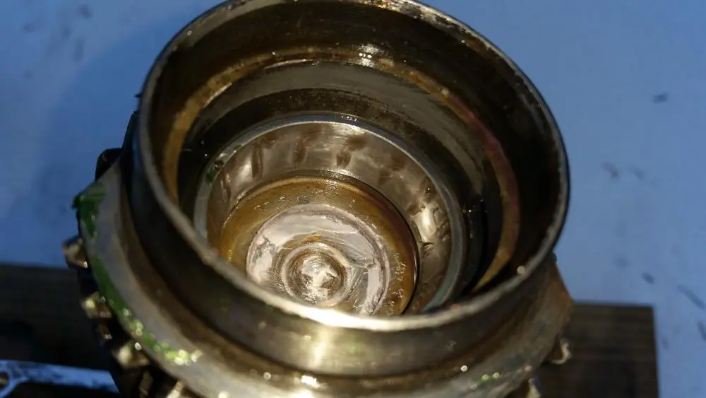

Ok so I tore it down today and I found some things.
Remember, this is after two years of regular abuse:
  • The main shaft was still in sad shape. I'm glad I'm replacing it now. Nothing surprising here
  • The input shaft (replaced 2 years ago) still looks brand new. There is no visible damage or wear.
  • The roller bearings are the same story. They look great and have no visible wear
  • There is no free play in the input shaft nor the counter shaft, so the shimming seems to be fine.

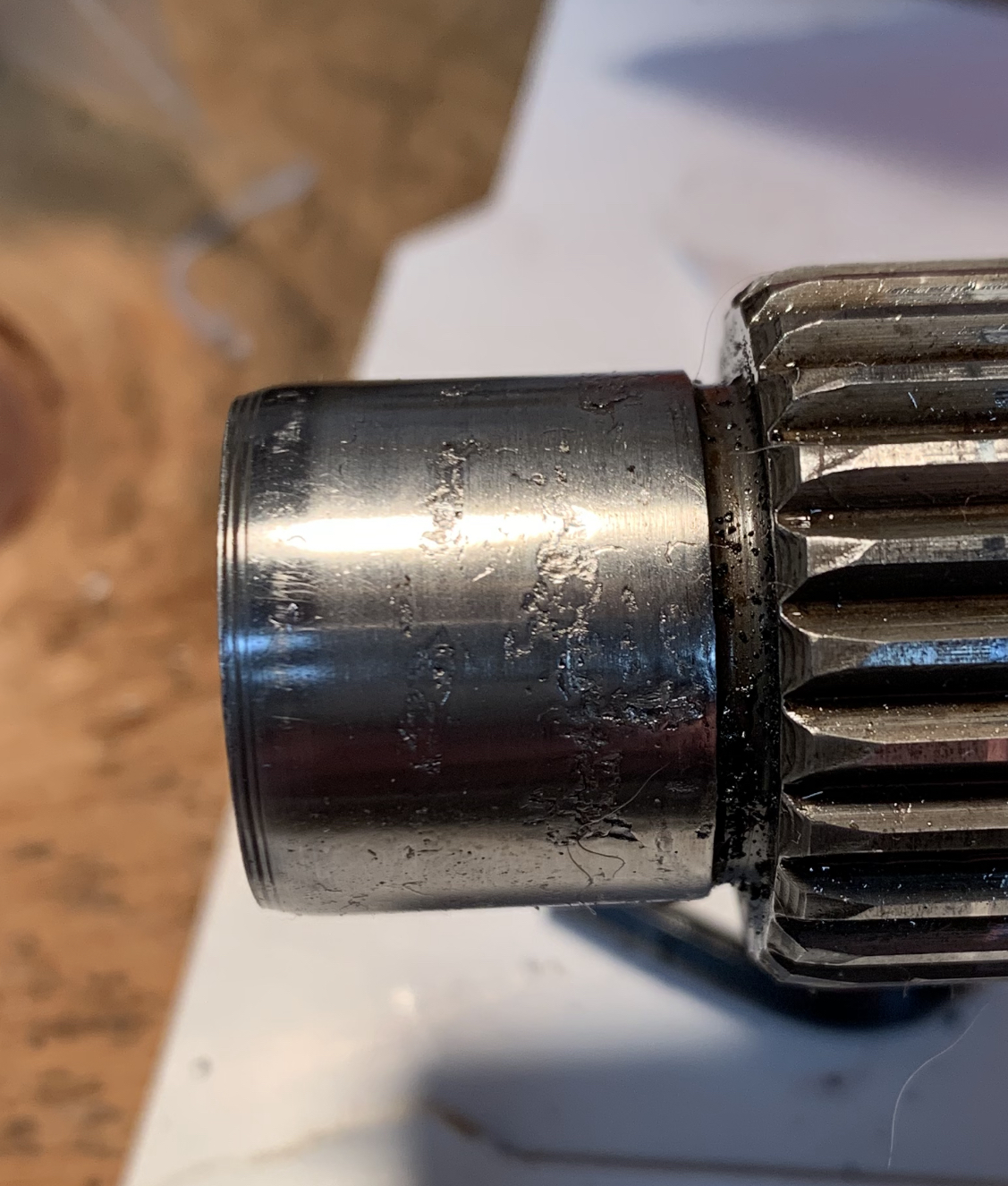

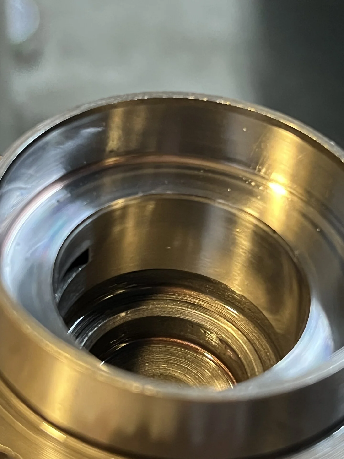

Pictures of the used input shaft:
Teeth look good and pocket bearing surface looks new... I cannot see a reason to not reuse it.
This leads me to believe that the damage done that originally made the transmission whine was due to either low fluid or wrong fluid.
It appears that no more damage has been done.
