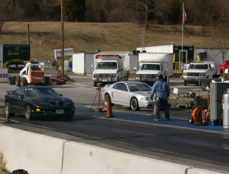

Here's a pic and vid. The camera is a cheap 5mp still camera so its hard to see the smoke right at the end
