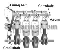

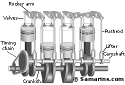

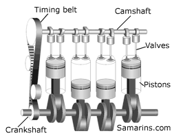

As for the tick at idle, I don't think it's a lifter, as OHC/DOHC engines don't have lifters. See here for a neat article on the topic of engines and configurations.
OHV:
OHC:
DOHC:

Bottom line: I think it's most likely valve clearance, partly due to age, climate, and oil temperature/consistency.
Hope this helps.
