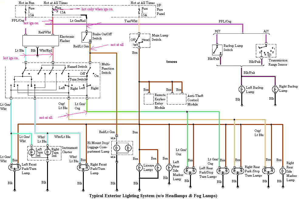

Here is the wiring schematic for the problem I'm having. On here I have listed what is hot and when. It's suppose to be hot at all times, but it's only hot when I have the ignition on. My motor sgt. said that reason being is because electric is just being recycled. He says the problem is before the fuse box possibly. What do you guys think? What should I look at next?

Check to see if your BOO switch is working, it may have gone bad. also check the flasher relay.

Also inspect the bulb harnesses/sockets...Do they look at all burned or melted or damaged in any way. You may just need some new sockets for the bulbs.

Good stuff from everyone so far.
I'd Turn on the turn signal and let it flash for a bit on that side. Then the other side. Then back and forth. If the fuse doesnt eventually blow, turn off the TS. Now press the brake for about 30 seconds. Then start pumping the pedal. See if the fuse blows.
The point is to isolate each system and try and get the fuse to blow so you can narrow it down.
I have the feeling it will be an issue on the brake light side of things.
Good luck.

Now the headlights won't come on?
Hissin,
I can't even get power to the turning signals or brake lights now because it is only hot when the ignition is on. It is recycling the electric some how when you turn the ignition on.

So when you turn the ignition on, and all fuses are intact, you have no turn signals or brake lights? If this is so, I agree that you likely have an issue before the fusebox. Check the underhood fuses (I cant remember off the top of my head if there's one for this circuit).
If nothing looks weird, I'd do some testing with FUSED jumper power. If the circuits work fine with the donor power source, you know your feed is bad. Start chasing the short that way.

is the wiring diagram where you have power and not have power still correct?? or has it changed??
