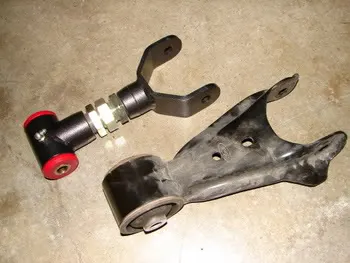

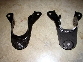

Last weekend I put in a Shaftmasters with the pinion adapter plate thingy. I also put in an adjustable UCA and mount to make sure I got the pinion angle right. It was all pretty easy, just time consuming if you don't have power tools. Overall I am really happy with it. It definitely makes a difference. I have some up close comparison pictures of the shaft, UCA, and mount if anyone is interested.
Here are some pictures of my Shaftmasters driveshaft, BMR UCA mount and BMR UCA.
Who doesn't like pictures right?

thanks for the pics, zero. the new shaft looks so much sturdier than the old one.

No sweat. It is a LOT sturdier but what you can't see is how much it DOESN'T weigh. The weight difference is staggering. As for your gear choice issue, I just bought my 08 GT a little over a month ago. The guy selling it was so not wanting to tell me it 4.10s since he thought he might scare me off. I must admit I was concerned when he told me. Every other Mustang I have ever had had 3.73s. I drove the car and was amazed with the 4.10s. I drive the highway to work everyday and never get tired of it or think the engine is winding too high. The 3650's 5th gear is a lot better than the T-5s. That's just my 2¢.
