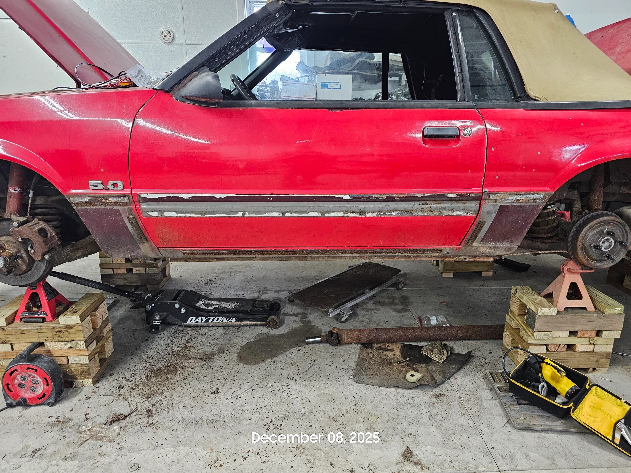

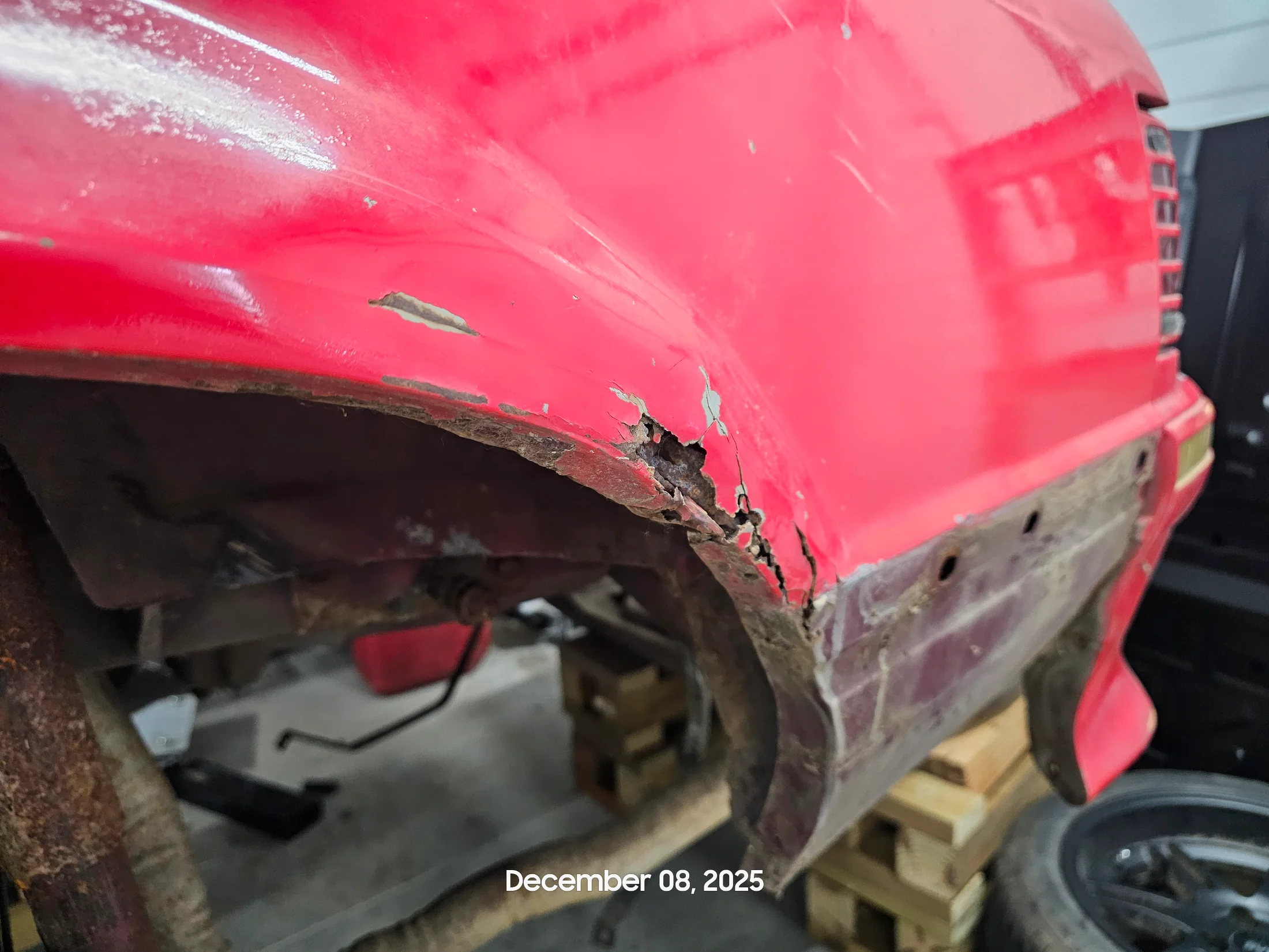

Been busy with a bunch of other stuff the past few days, but I took a couple hours and removed the side skirts on the driver's side. The rocker looks solid, the door has some paint lifting from under the molding, and the lower mounting bracket is kinda nasty. Also looked a bit closer at the rear quarter where the damage is as there's another patch panel up on Ebay. It looks a bit better than the one I have now, but it also looks like it may only have the bare minimum of material for what needs replaced. A new quarter panel would definitely give me enough material to work with, but I can't see myself spending that kind of money on one right now. Good thing I've got plenty to do before I need to make that decision.

Take a shop rag and put a magnet inside of the rag folded over the magnet once. Gently run the manget over that area as there is bondo all over it. You can tell where the bondo is by how well the magnet sticks to the car. You may need a larger panel than you think.

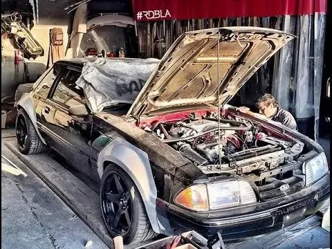

Wide body time

RaggedGT said:
Wide body time
I've toyed with this idea.....
Someone made (or maybe they're still available? Haven't looked in a while....) slightly wider flares that more or less look stock. Thought that would be the way I'd go if I did it.

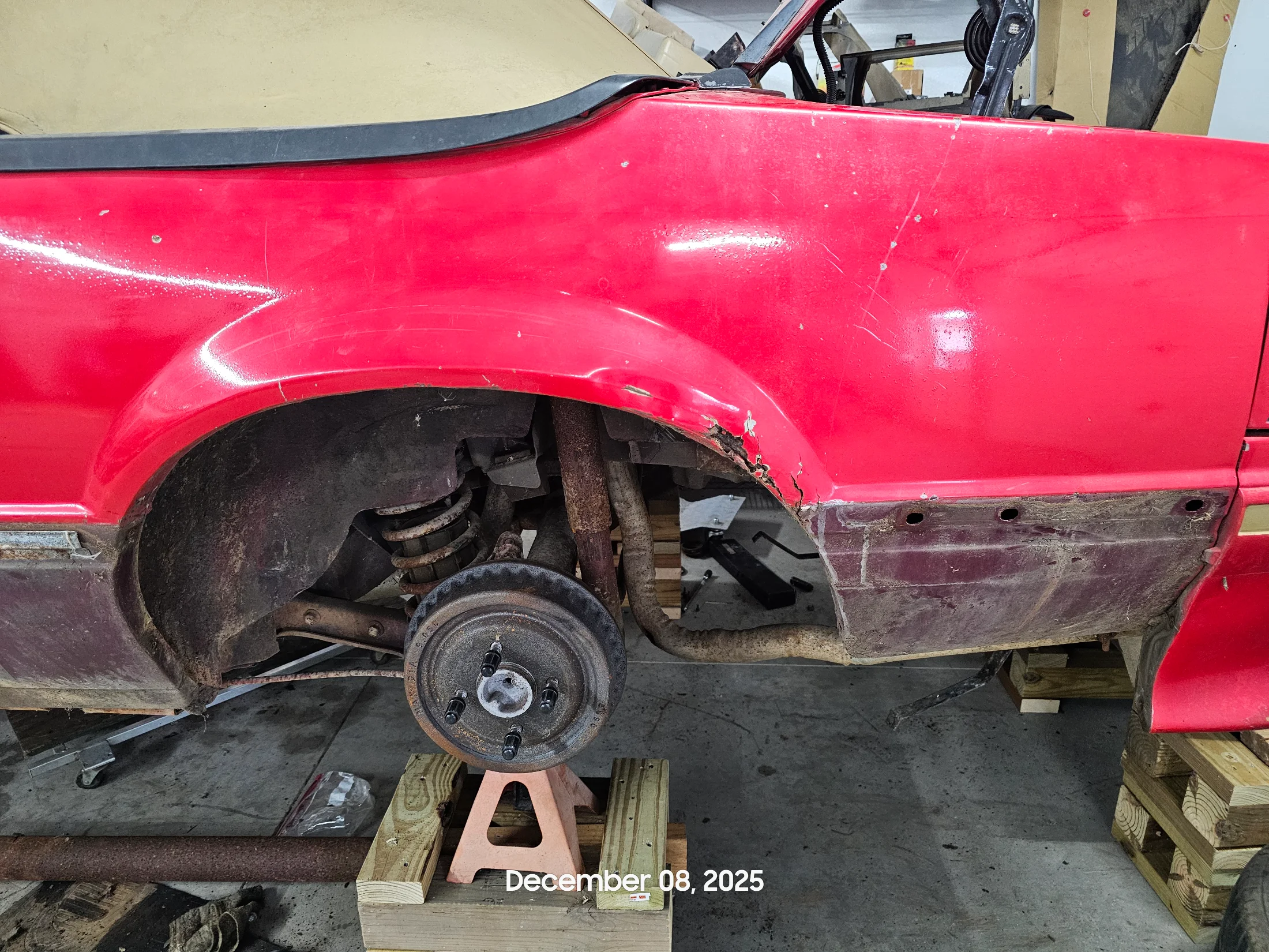

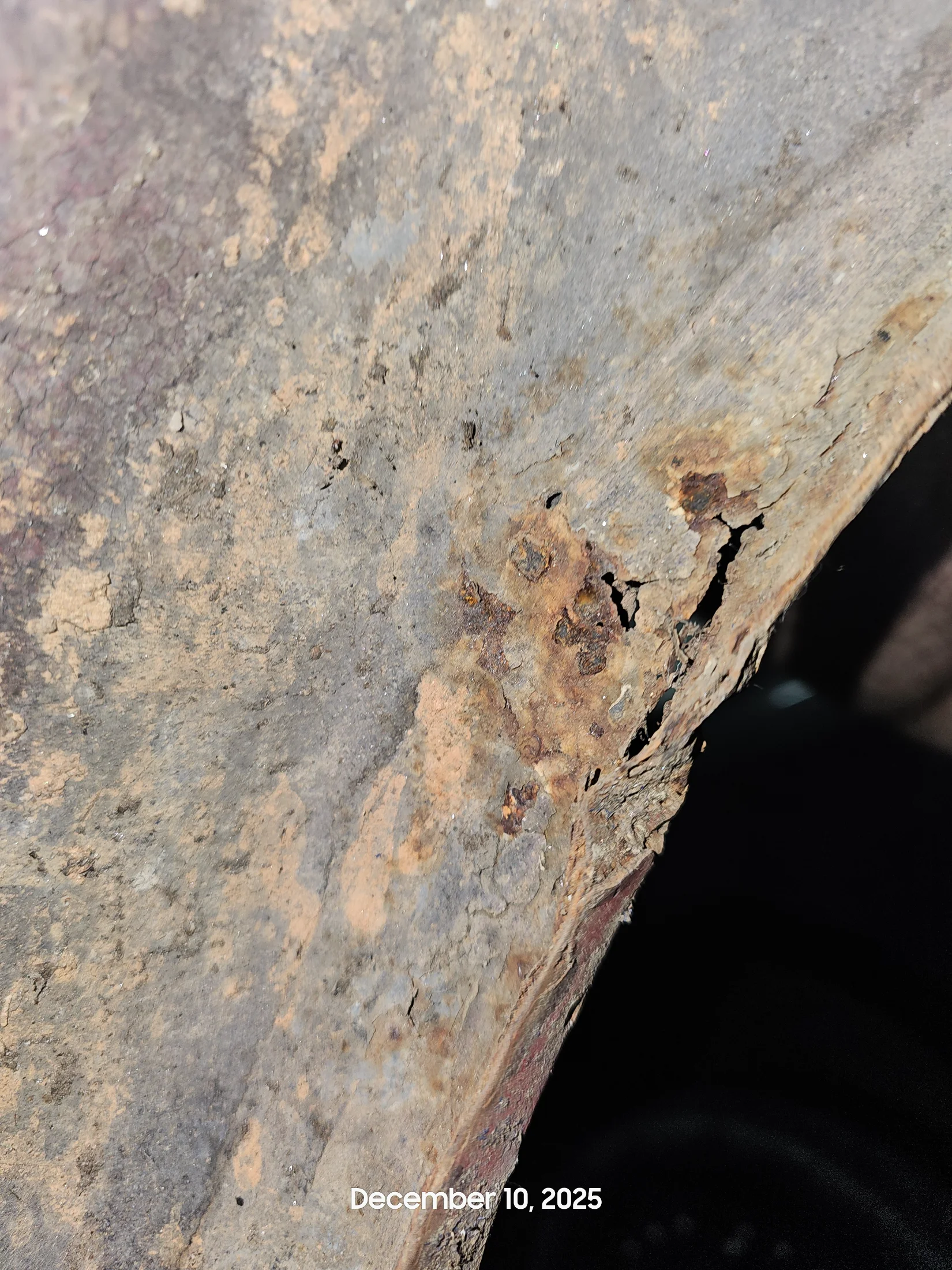

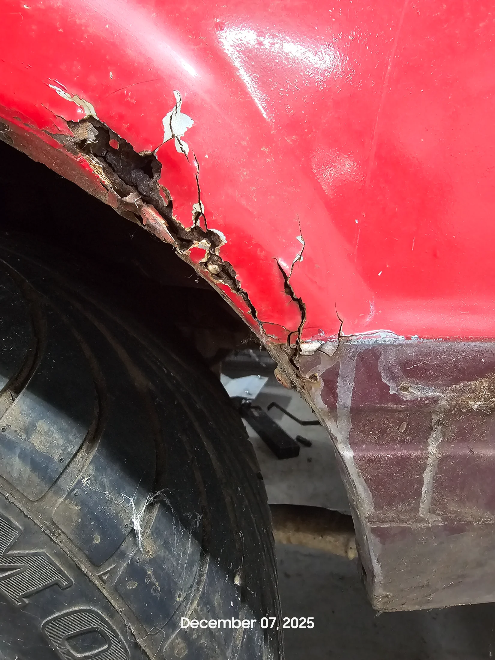

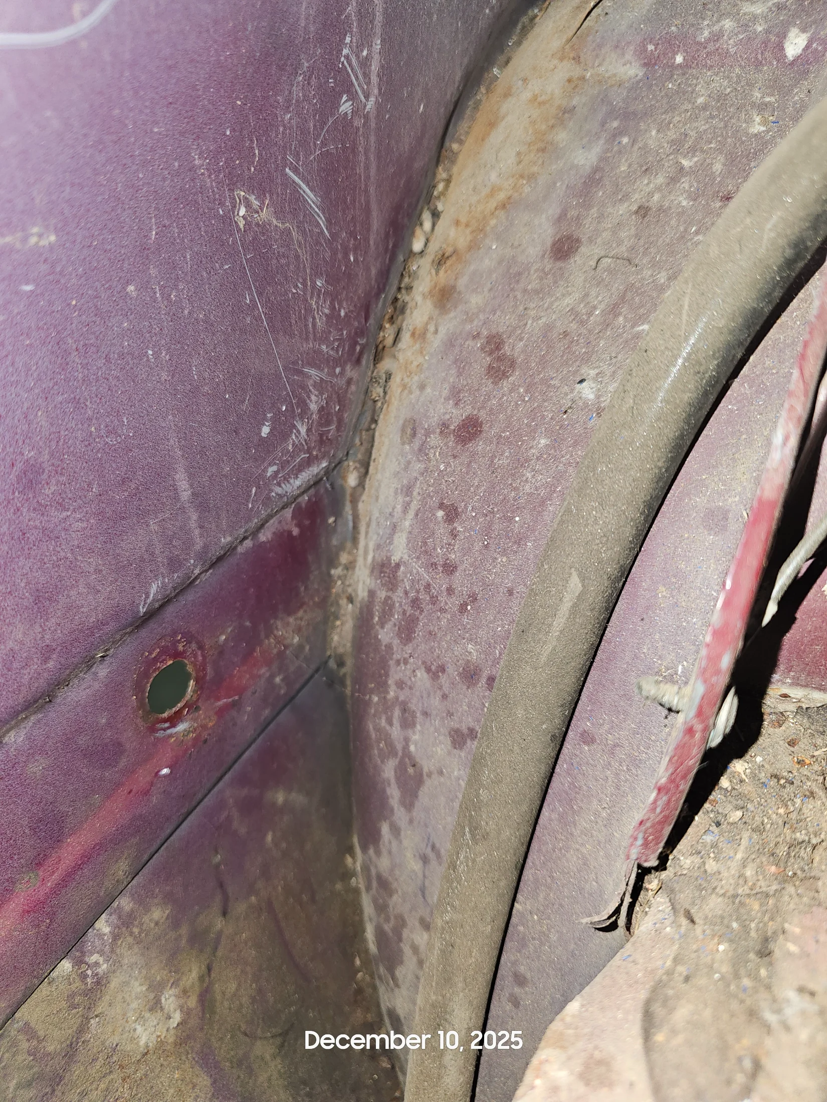

Here's more of that area of the quarter panel. I don't think there's anything there, but it's possible.
Inside the trunk
Backside of the wheel well
