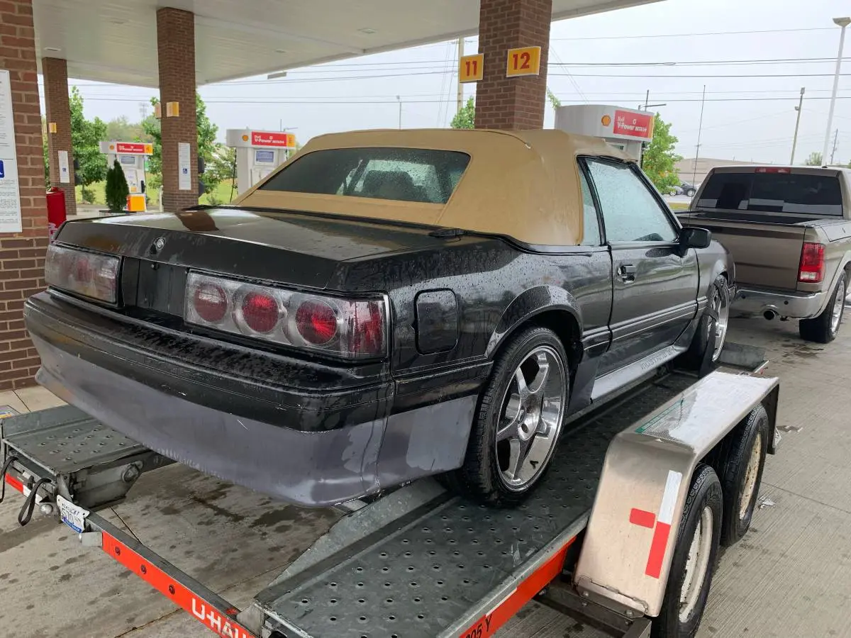

Sometimes keeping your eye on for sale ads pays off in ways you'd never expect.....
I was perusing Craigslist and come across this ad:
Convertible Top from 1989 Mustang - auto parts - by owner - vehicle...
Canvas convertible roof with rear glass pulled from a 1989 Mustang. Can not guarantee that the hydraulic motor/ system works, but the top worked fine manually while it was on the car. Just needs a...
atlanta.craigslist.org
He's selling this complete top/frame assembly:
It looks pretty good from the pics, and the price isn't all that bad, and I've been thinking that I want a tan top....
Gonna get a hold of him and see about picking it up over the next couple of days. He mentions in his ad that he's not sure if the hydraulics work, but I just happen to have 2 sets here so I don't care about any of that. As long as the top is decent and the frame isn't jacked, it's kinda what I want to do anyway. Fingers crossed!

Picked that top up. It's a little dirty, but otherwise it looks to be in pretty good shape! It's now taking residence in my shed with a lot of the other parts I've picked up.

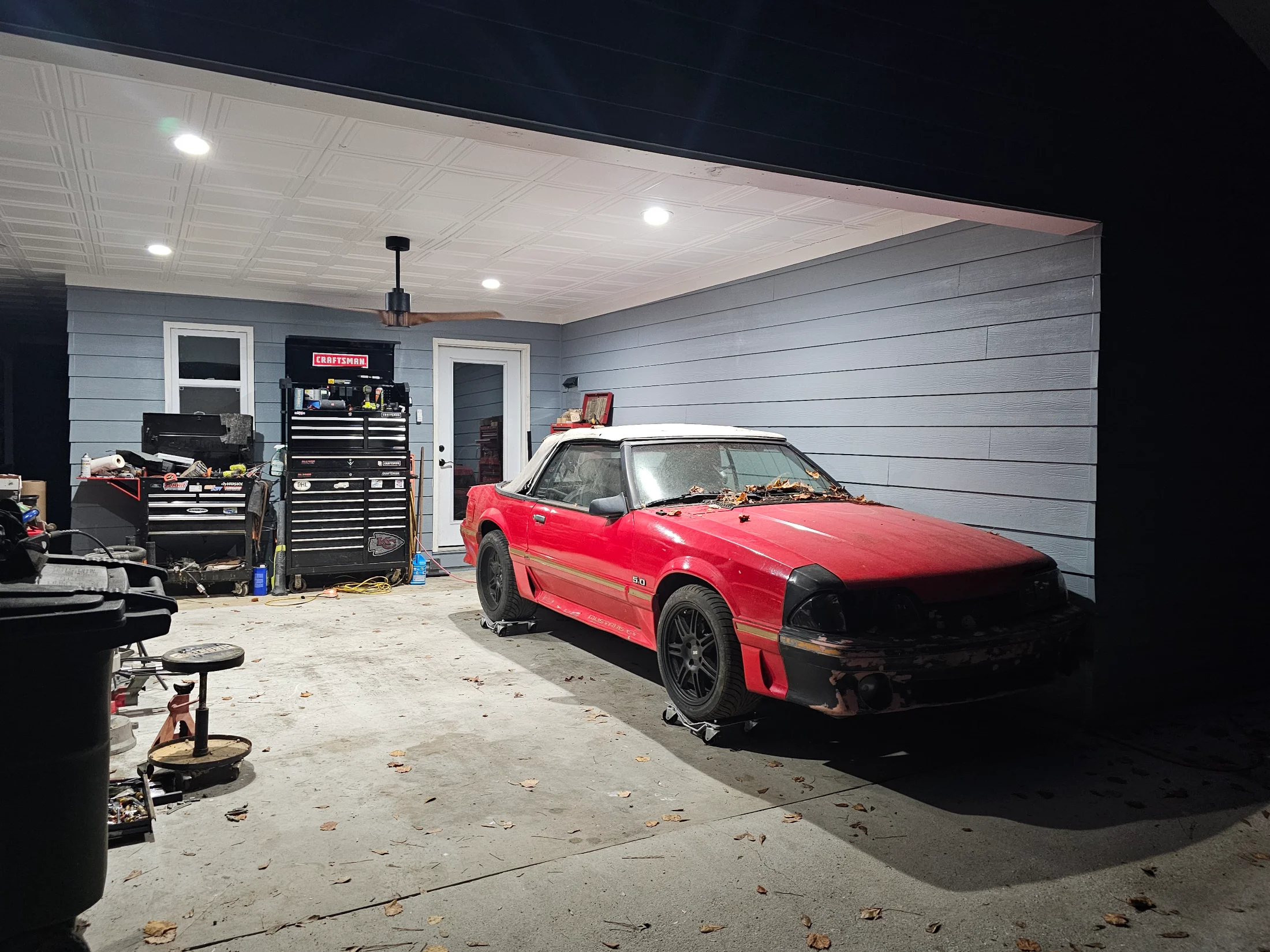

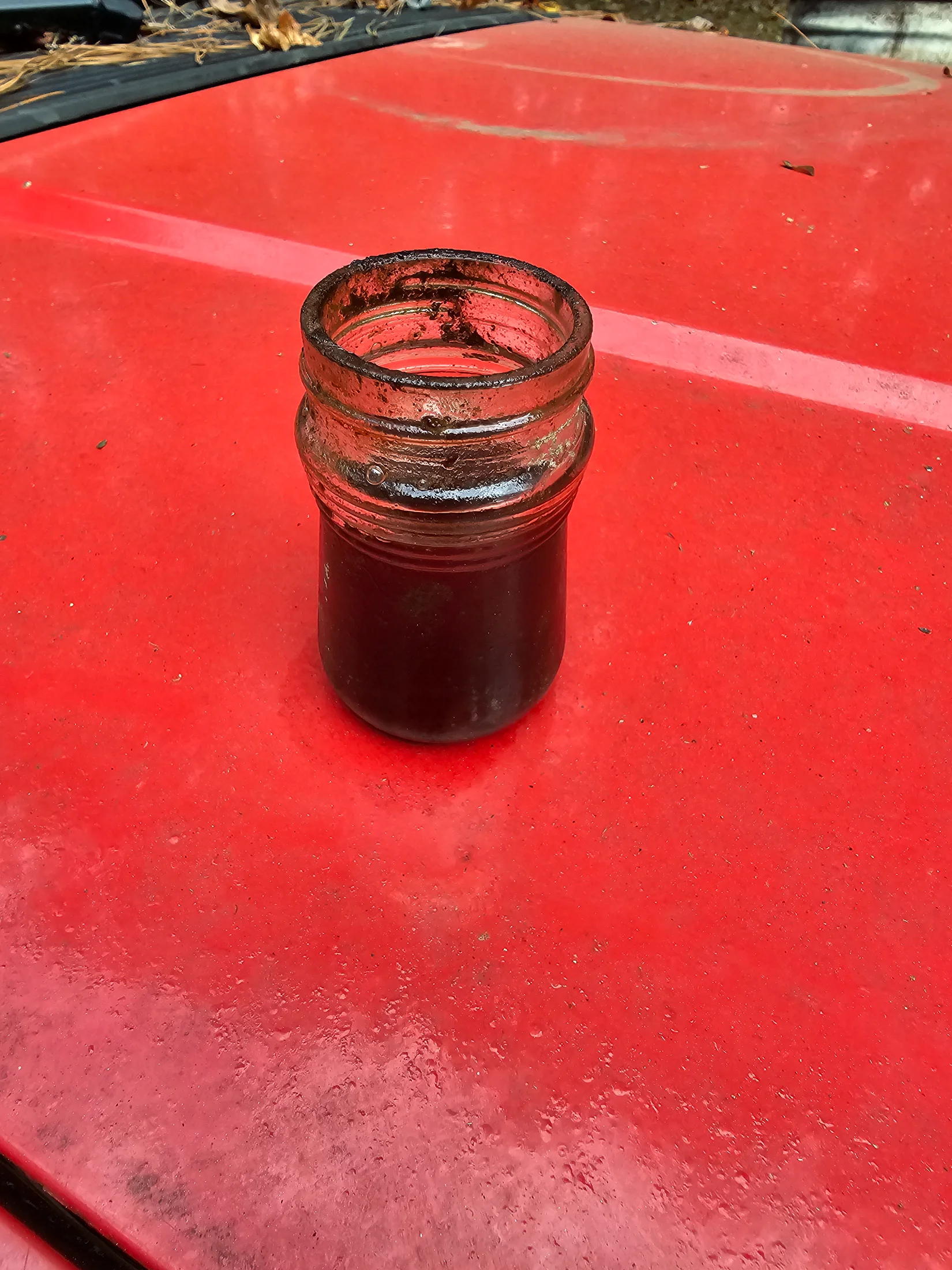

Finally pulled the vert out from the corner to be able to get to it a little easier.
Once it was out in the open a little more I grabbed my siphon pump and emptied the tank as much as I could. There may have been a gallon that came out if I'm lucky, beyond that the pump was just sucking air. Here's what it looked like....
Now to figure out how I want to go about clearing the lines. What kind of suggestions does anyone have? I was wondering if I'd be able to drop the tank, disconnect the feed line, then use compressed air on the Schrader valve under the hood to blow it out. The problem I have with that idea is what might it do to the injectors?

Disconnect the feed and return lines from the injector rails. Clean the lines with them disconnected. If that color of gas comes out of the rails you may need to service the injectors and clean the rails.

Thanks! Yeah, I suspect the fuel that's still in the lines will look like that. At this point all I really want to do is get it running so I can move it under it's own power. That way I can get it moved under the carport with my Cobra and get them out of the way for contractors to have access to the back side of the garage pad. With any luck I'll have an actual garage sitting there by this time next year! Then, if all goes well, things can really start progressing on the cars.

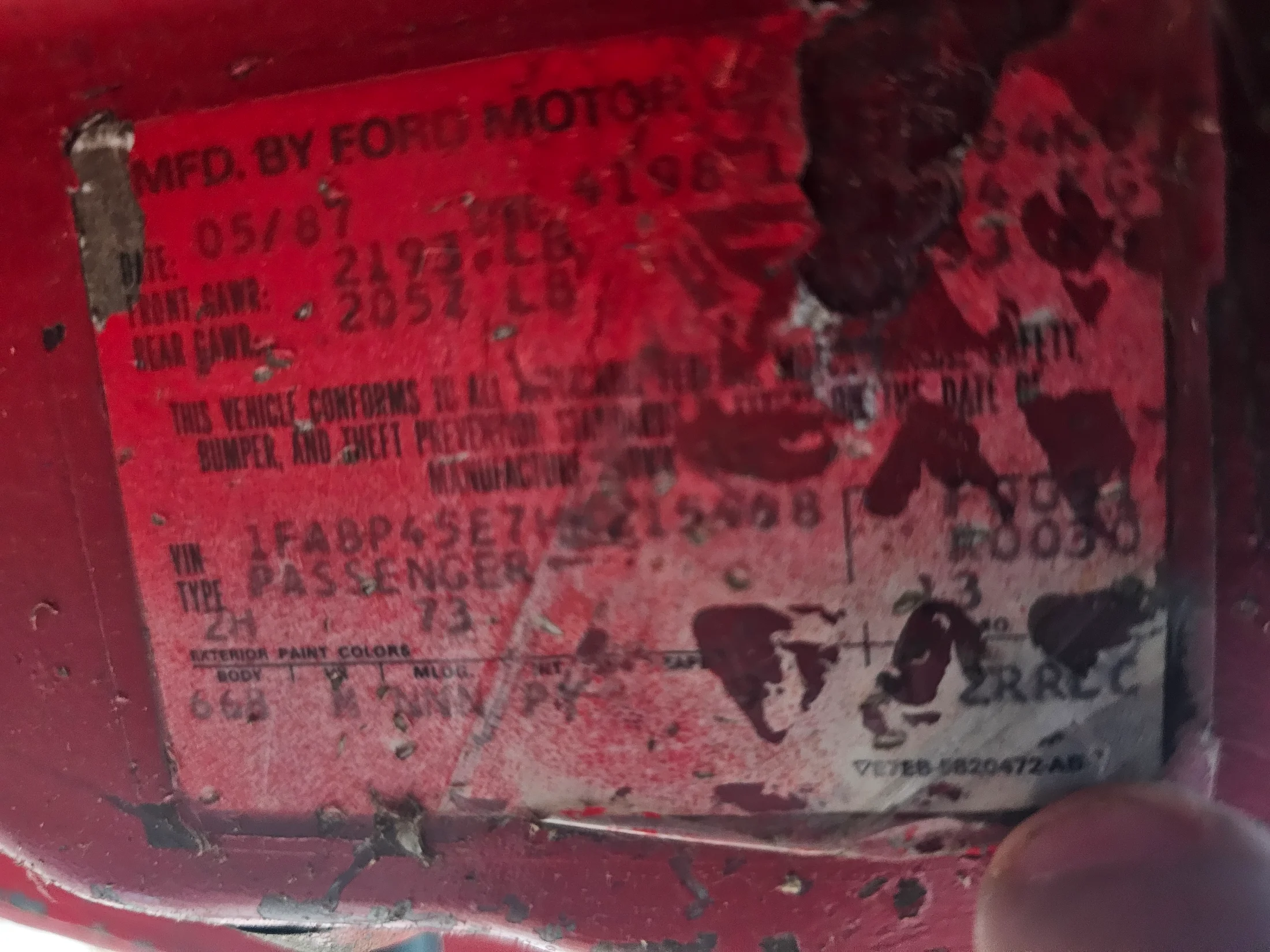

Side note: I think the door tag has seen better days....

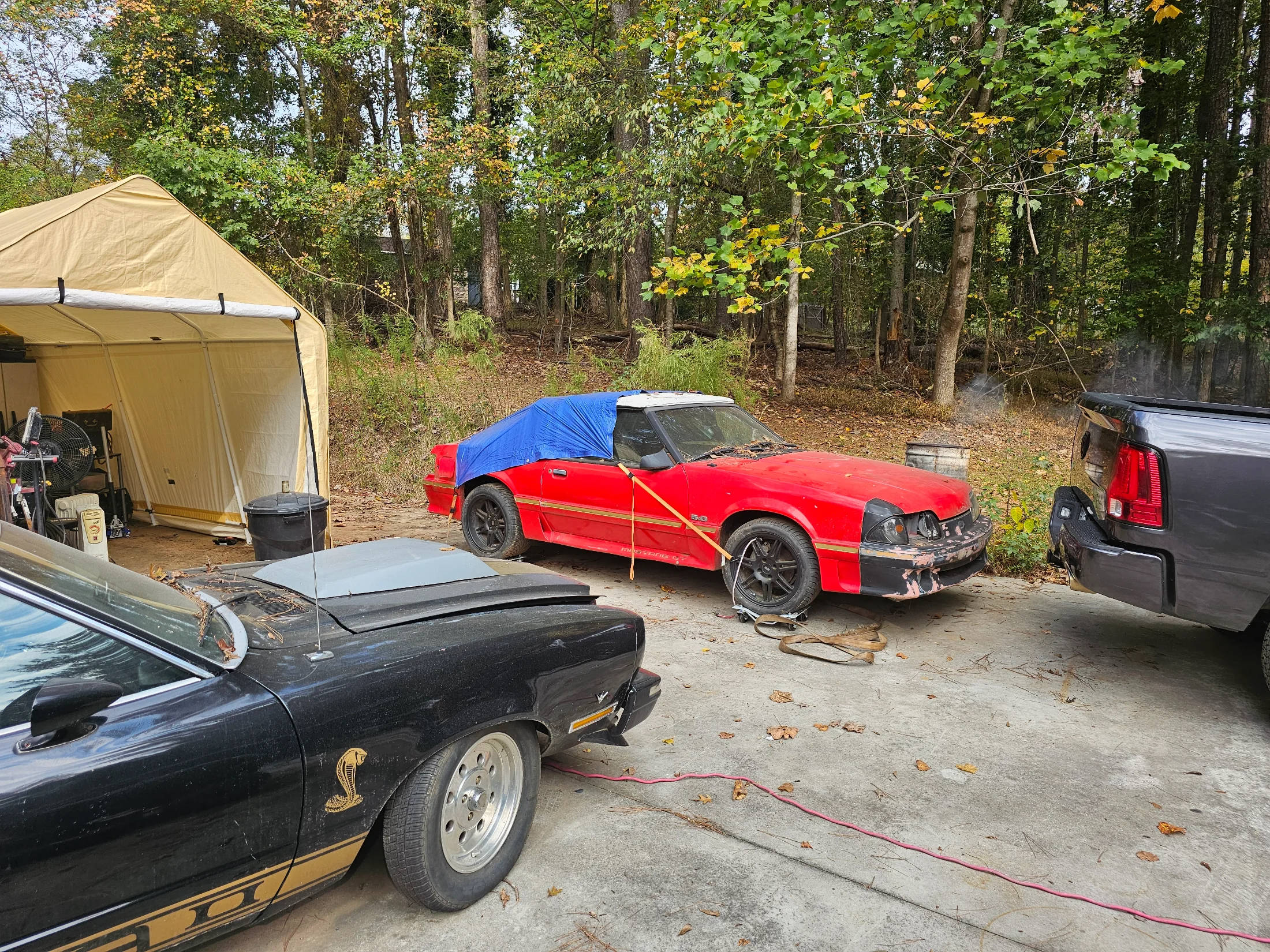

So I've got good news and..... well, good news!
First, I was finally able to separate the fuel lines! I've never been able to get that accomplished before. It took me just a couple minutes to get the return line but the feed line fought me for a good 30 minutes. Once I got those apart I took compressed air and blew the through the fuel rail. Then, after putting between 4-5 gallons of Sta-bil treated fuel in the tank I cycled the fuel pump a bunch of times to try to clear the feed line as much as possible. Once I was satisfied with that I put it all back together and WALLA!! It started up pretty quickly, stumbled for a minute or so then purred like nothing was wrong.
View: https://youtu.be/VCGYxfQf04I?si=MrffqPc-QtHxfz_M
So now, after I deal with the Cobra's water pump, I should be able to pull them both off of the garage pad and into the newly refinished carport under their own power.
