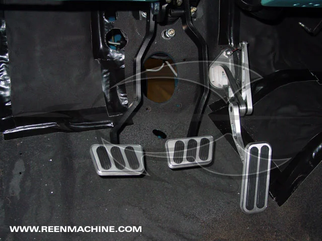

I just got a couple sets for the fastbacks. Install is easy, but you may have to move your fusebox up a little bit. I also had to trim the edges of the pedals just a touch with a die grinder to get the Lokar pads to fit over them. No big deal at all though. Looks like a great product! Yes, I'll post pics soon.

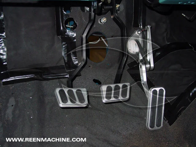

I installed the pedal pads today and took some pics, and have a throttle pedal installed as well. I'll try to get the pics up this weekend. In the meantime, I'll say that they seem to fit and work as advertised, and the gas pedal is waaaaaay easier to install than the Lokar Eliminator floor-mount pedal I put in the red convertible.
Here's how the pedal pads go on, using the brake pedal as an example. I had to shave the edges of the pedal just a touch to get it to fit down into the recess on the back of the pedal pad. This may be because it is a repro pedal, but it was no big deal anyway. Then mark where the two holes go, drill the pedal, and attach the pad with the supplied countersunk screws and locknuts. Lastly, put the two rubber pads in, gluing them in place with the supplied adhesive.
