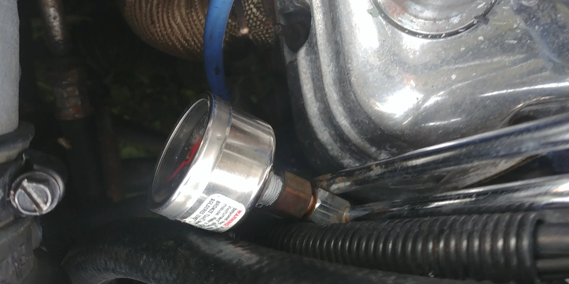

I have a Kirban FPR and mounted a gauge in place of the schrader valve.
Yes exhaust manifold. Could have a fuel injector leak, could have a gauge on FPR leak, could have FPR leak, could, could, could,... if you are afraid of the could, easy solution is don't fire up your car. You won't have a leak and no risk of fire.
Gauge has been there for years, installed right is no problem.
Just humor. Although the reason most stoped doing that is quite a few people had that very problem. That's why the advice above was given. But I agree, can't worry about everything.
Likely reason for the gauge/adapter failure was improper install or cheap parts. There is some vibration, but as you can see, it does work ok.
