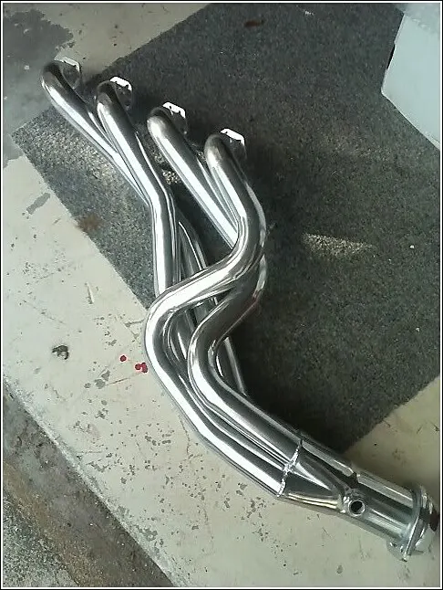

I had purchased like 4 exhaust systems for my 94 and when I switched to the 347 stroker I wanted quality long tubes. As you know our choices are limited. One thing's for sure I wanted ceramic coated headers. Had Stainless, had chrome, etc.
I purchased MAC 1-3/4" Ceramic Long Tubes with 3" Collector, MAC 3" Prochamber and MAC 3" Cat Back. I am very pleased with the quality, fitment and of course sound.
I'm impressed.. the ceramic coating on those looks really good.. My BBK's are dull and look like ass
