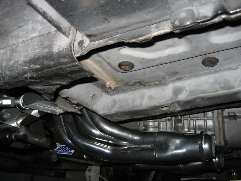

They are in!!!!!!!! Had to lift the motor and move it forward kinda slipped right in. I have plenty of room. Around the bell housing and everything. They are for a 93 and the fit perfect no egr hook up for those who deleted the Smog anyways. Thanks for the help i will post up pics. BTW i left my motor forward to it original position. The only casualty of my install was the throttle cable that got caught between my intake and firewall so it is now binding. Almost done one more thing in the books.

Looks really nice from under here.

Just put a board under the Oil pan, with a floor jack. undo the passager motor mount and jack it up about 3 inches....just about where the motor mount stud slides free. this is only for the passager side. The other side is a bugger, but eventually slides in on the drivers side under neath. I just disconnected the steering shaft.
