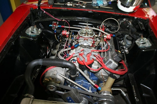

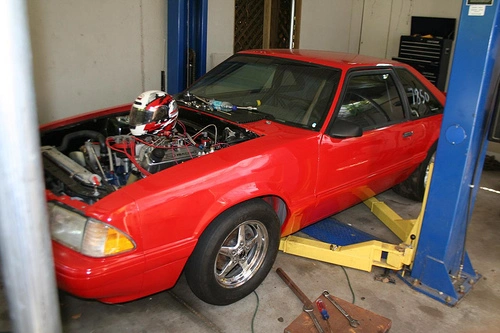

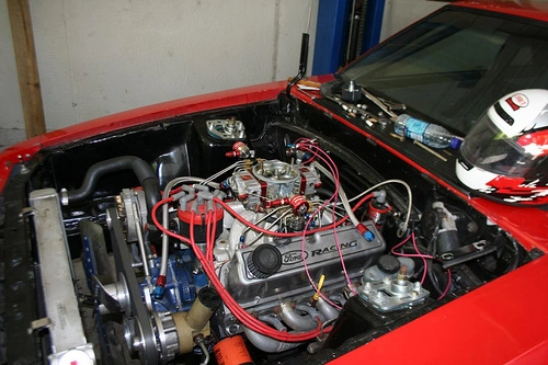

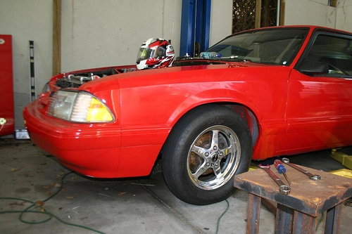

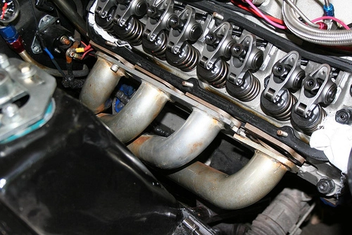

Well i started to install my new 2" hooker long tubes the other day. I had to design some custom adapter plates for them to fit my heads but i just got those pieces back from the water jet the other day. I got the plates installed and started to try to get the headers in. Its like trying to stick a 6" pipe into a 2" hole..... This has to be one of the most difficult things i have done yet on this mustang. Where the firewall/floor, k-member, and bell housing all come together is such a tight spot to try and fit (4) 2" tubes through. Well after 2 full days of screwing around trying my hardest not to have to lift the motor out, we some how got it wedged through and the passenger side is in place. I will have to modify the trans cross-member because the collector is hitting it. I think the driver side should be a little bit easier, i think i might be able to go through the bottom and clear most of everything. I'm just waiting on some gaskets to arrive some summit and i should be ready to hit the track again. I also got my Dynamic Racing Mighty Mite C4 installed and its ready to go, went yesterday and picked up my new lengthen drive shaft for the new C4. Here are some pictures of the progress.
What do you think?
-AJ

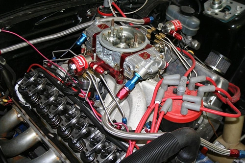

351w bored & stroked to 410. Forged Internals, AFR 205 Heads, Vic Jr intake, Quick Fuel 750 Carb, Cam Motion custom cam .690/.680 lift, Direct Port Nitrous Injection, Mighty Mite C4, Hooker Long tubes - 2" Primaries to 3.5" Collectors.

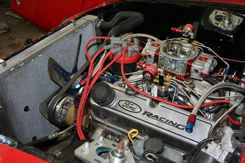

first thing u need to do is take that fan off and put in the trash. its been a few years but the next door guy had a old a old race car and he was jacking with the timing chevy so he had to lean over the fan to move the dist. his wife said she heard the motor rev high a few time and then she never heard it rev back up so she was thinking he was done. she said she told him dinner was done come eat. she could not see him. she a few min went by and he did not come in and the car was still running so she went out to get him. she found him died the fan had came apart and the 1 part of the blade come off and he was gone.
i doing a 427 with highport heads and i talked to kooks and they said they make headers for my combo. 1 other thing is i have a upr k member and the one part that come out the upr kit is under the cars frame. this 1 guy made a tranny crossmember for dual exhaust.

are you sure those are 2 inch primary's? they dont even look like 17/8
Yeah the fan does need to hit the trash, i haven't really been wanting to spend the money on an electric one, lol. I already modified my trans cross-member to fit around the collectors.

Yup im positive they are 2", i measured them and ran the product number on summit and they say 2" also.

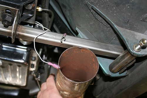

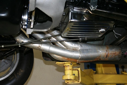

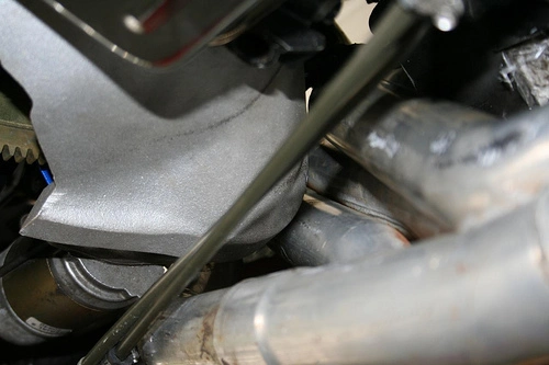

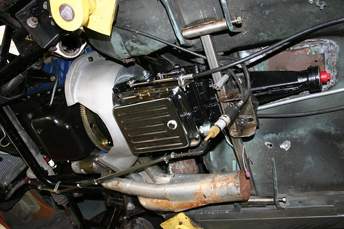

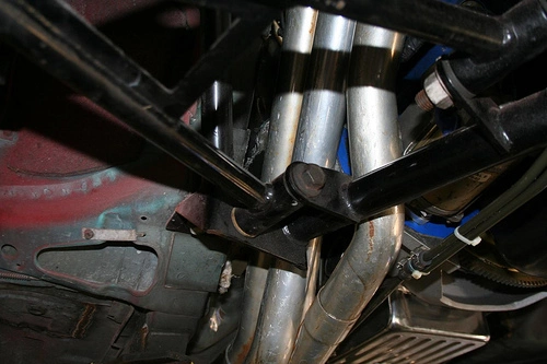

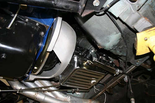

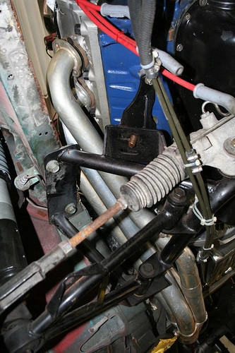

Well did some work tonight and got a good amount accomplished. I cut the old crossmember and got a good idea how im going to weld it back up to clear the collectors. I ripped out the stock steering shaft so i could put the driver side headers up through the bottom. It was so awesome they slid right in with no problems, i have to countersink my adapter plates for this side and they will be ready to go on. Im waiting for gaskets to arrive before i can bolt the headers to the plates.
I was told to use red silicone paste between the headers and the adapter plates, has anyone ever used this stuff before? Does it need to be just red silicone or high heat **** or what?
Ill have some more pics up in a few days and maybe a video of it running again.
-AJ
