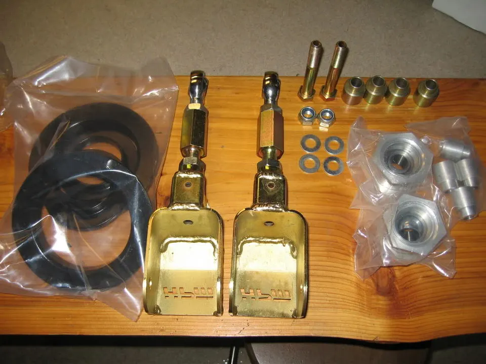

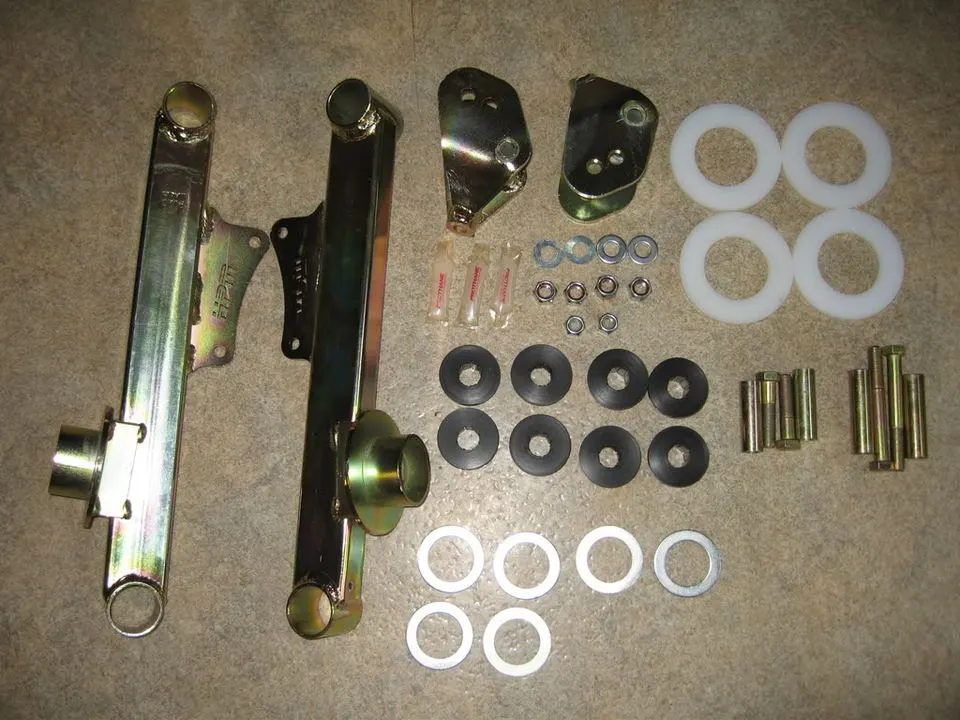

The Turbo Notch is going to need all the traction it can get. These should do just nicely.

Awesome! Those will definately work. Just to give you a little helpful hint, use these with an adjustable shock. I have had these on 3 different cars and am even personal friends with one of the guys who designed these. The lowers work wonders at moving the instant center of gravity when the rear twists, but they unload the rear tires just as quickly when the rear end recovers. An adjustable shock will save you a lot of heartache as you tune that suspesion. There is no magic number that works with every Mega Bite set up. It all depends on things like tires, launch rpm, car weight, etc. But your chances of buying an off the shelf fixed return rate shock that will work well are slim.
Solid lower control arms don't suffer from the "twist release", so the cars can be more forgiving. But when you get your set up right it will be amazing.
Good luck and good purchase!
Brandon
Thanks! And I do have the Strange 10 way adjustables on order. As we speak they are in KKP's shop. Tried to get ahold of them many times on Saturday but I guess they were not open. Thanks for the advice.
