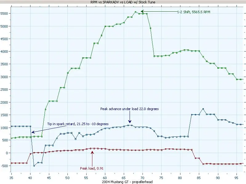

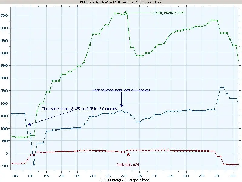

propellerhead New Member Apr 13, 2004 1,541 0 0 "but what's with the but shots?" Dec 16, 2004 #22 Dec 16, 2004 #22 A chart with the factory stock tune and one with the new r50c Performance Tune. Attachments Timing_121504_stocktune.webp 28.4 KB · Views: 110 Timing_121504_r50ctune.webp 32.1 KB · Views: 103
