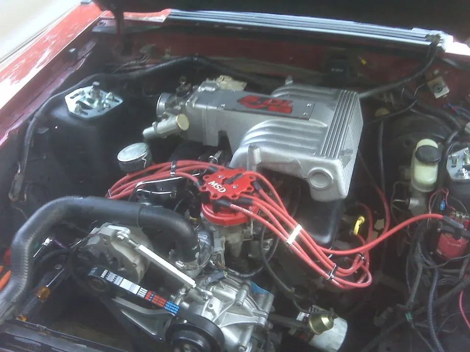

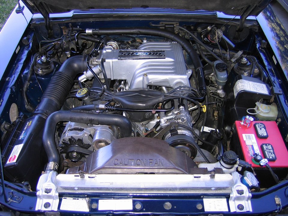

okay, got the valve covers and the upper intake off. now it is decision time... powdercoat them, chrome them or sell them and go with something "nicer". Advice?
i know everyone says that its basically your best bang for the buck. But it has to look stock. Looking for pics of this mod, if it passes the "stock" look test then I will start hunting one down.id go with an explorer intake and high temp paint in "aluminum" the explorer intakes come bare aluminum from ford
Really???? Well damn, guess it passes. So I need the upper and lower from a 1996 explorer v8 and everything bolts up? Anything else off a 96 I should grab for this swap?

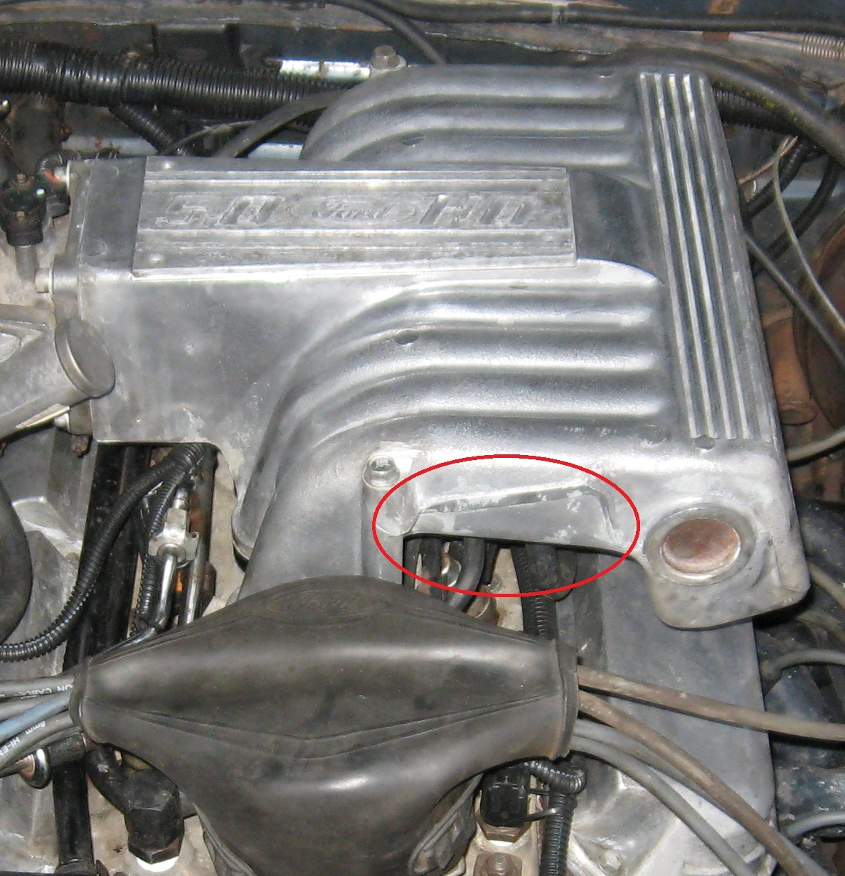

Yup....although it could very well just be a clear coat of some type, but it's definitely not bare. You can still see bits of it flaking off in this pic....
Gonna have to sand blast the whole thing and start from scratch.

Why does everyone leave that 'ear' stuck off the side of the intake when they swap?
I think it bolted down a bracket to anchor a cable? Throttle linkage?
It shaves right off in seconds... Leaves a nice clean look.
The pic shows the intake without the 'ear' on the side, and the red shows some of the silver paint flakes that didn't want to come off.
That is some TOUGH paint.
