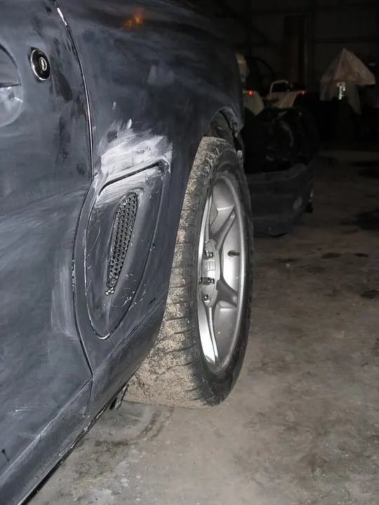

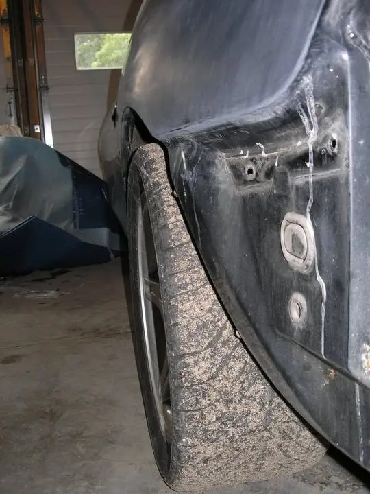

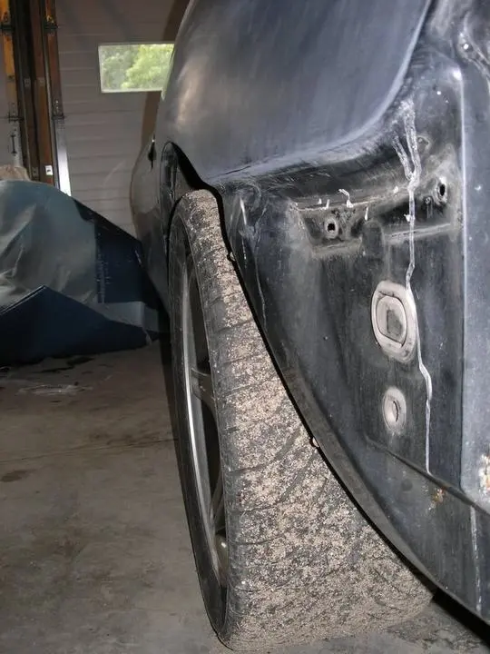

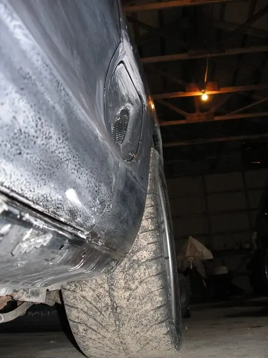

pics as promised...
1 1/4 inch spacer on 275s. I wouldn't suggest going smaller than 1 in. on 275s and definitely go 1 1/4 + on 255s.
