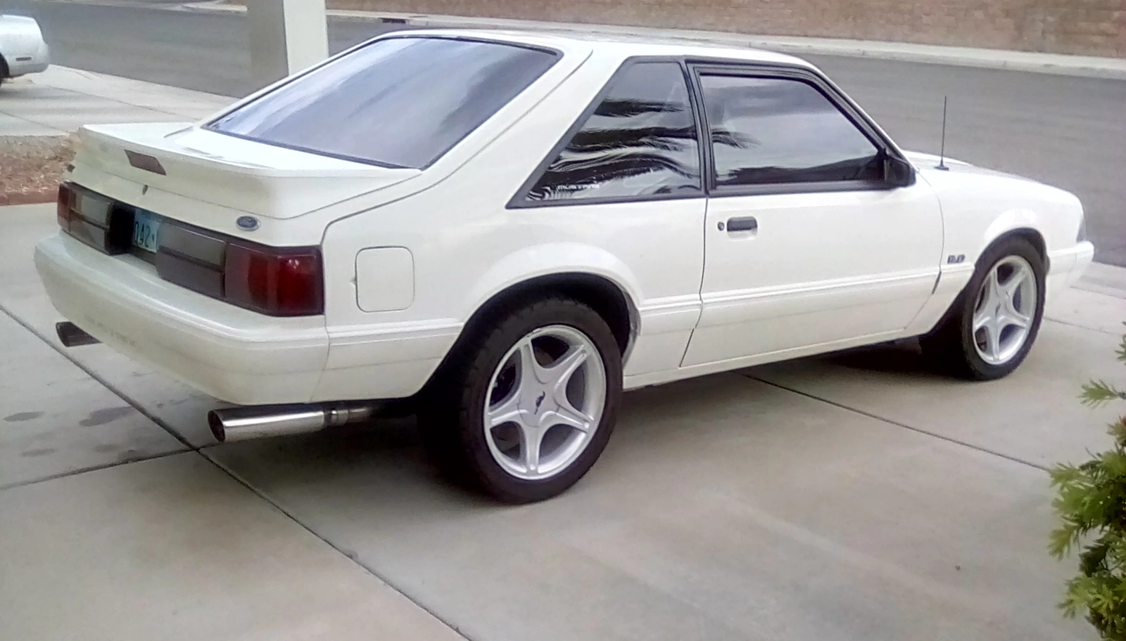

I've had flowmaster and now have Slp loudmouth catback.
I love the loudmouth sound and large tailpipe tips.
