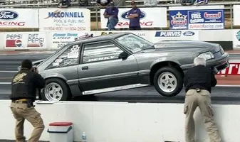

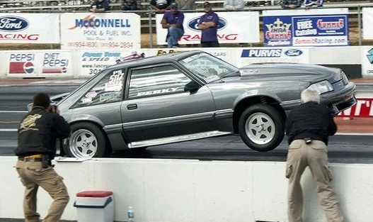

Prostars don't come in 4 lug.. Bogarts aren;t as much as people think and look sweet.. Here are a set on my car.. 4 Lug
