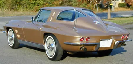

http://usedcorvettesforsale.com/images/years/1963.jpg

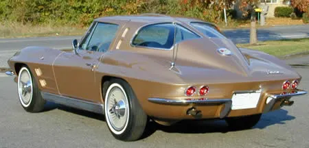

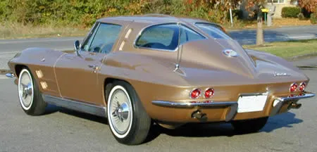

Pakrat said:
One thing I am dying to do is to add some type of vent(look) to the front fender between the door and the wheel well, kinda like the Ring Brothers do as made most popular probably by a 78'ish Trans Am/Z28, I had a seperate thread on it a while back, the ideal situation would be a set that looks like you see on a BMW Z3 but 3 gills instead of 4. Ijust think this would look so hot. I have come up with a quite a few options some even stick on but I DO NOT want to look ricey here at all. Any comments or thoughts?
EDIT, oops one last thing, as opposed to modifying the Shelby rear deck lid and end caps to keep my stock lights or going with the Shelby tail panel and Shelby lights to make it easier I have been toying with another idea, tell me what you think. How would a custom tail panel look if I bought 6 pieces of round vette tail lights kind of like these and put three lights on each side instead of 2 to maintain the ford 3 light theme? Is this sacraligious?
You asked for opinions, so I have to state that I don't think the side vent thing is going to work. It might work if you wanted to do some other mods that would fit with the side vents, but for the most part it sounds like you're wanting to keep the body very stock appearing with the exception of the side vents and tail lights. I just don't see the side vents and/or tail lights blending in on a car with a fairly stock body. With that being said, I think you will go a long way towards your goal focusing on fit and finish.
It seems to me that the ideas tossed out here only confirmed in your mind that you want to keep the car fairly stock appearing, which is fine, but IMHO, if you go with some radical styling cues on an otherwise fairly stock body, they will stick out like a sore thumb. By the way, I'm not opposed to the tail light treatment you suggested and have considered the same myself, but I ultimately determined that the only way I would be able to pull off round tail lights would be going with some sort of Ford tail lights ar custom tail lights. I hope this helps. It's just an opinion, and we all know what opinions are like. :D
