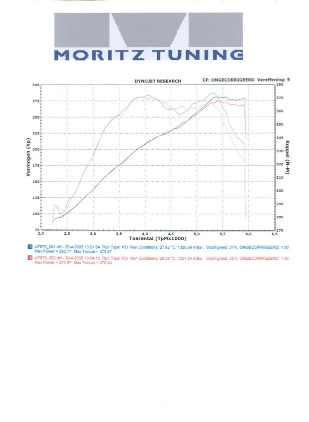

I have a Torker II. From what I hear, it is crap, which might explain my unsatisfactory dyno numbers. I have been recommended to swap it out for a RPM Air Gap. Can anybody with experience opine on this:
Here is my build
1969 351W bored .060 over
forged eagle rods
forged Wiseco flat top pistons @ 11:1 CR
Edelbrock RPM Performer cylinder heads 60cc combustion chamber and 190 cc intake valve
Edelbrok Torker II single plane intake (makes its peak hp between 2500-6500 rpm) Holley 650 cfm 4 bbl carb (double pumper with vac secondaries)
stock 80 gph fuel pump
MSD 6AL ignition and HEI pro billet distrib
C6 transmission with 2200 stall converter and a trac loc
Here is my cam grind:
ADV DUR: INT 297, EXH 308
LIFT: INT 538, EXH 534
DURATION AT .50 DEGREES: INT 236, EXH 242 @ 108 centerline
dyno numbers are attached. I am at least 50 rwhp from where I should be.
In additon to the new intake, I am also thinking about bumping up to a 750 carb. A holley blue fuel pump arrives Tuesday. Please feel free to comment or make constructive suggestions.

i cant really tell for sure, but you're graph has a funky shape on the top end
was your a/f ratio good?
i would almost bet money your problem is the STOCK FUEL PUMP
as far as the torker 2 being crap, id say its very combination sensitive - with most people not having the right combination
from what i understand, i would first upgrade the fuel pump and then if you're still unhappy id get a performer RPM intake (possibly air gap if it fits and you have a decent way to get fresh air in your engine bay)
I think you will still have at least 2 problems. First, the way tq and hp look at around 5k, there is something wrong. Hp flatlines and tq just disappears, not a "normal" looking graph past 5k. A/F ratio in that range would help diagnosis. I don't think an intake change will cure that. Second, I've heard that a C6 can gobble up a substancial amount of power, up to 40 more hp than a C4. That sounds extreme to me, but they are known for lack of efficiency. Those 2 things will get you more in the ballpark of what you looking for.

I don't know what the A/F ratio is . I was going to stop by on Friday and get that plus the total timing but the shop was closed. I was planning on adding a shot of NOS once I get my tune down. In anticipation of this, I just ordered a Holley Blue, so we will see if that cures things. As for getting fresh air to the engine bay, I am going to "open" the hood and make my hood scoop functional.
I am going to ask about that tomorrow. What should the numbers be? the shop told me they thought the problem was in the carb. Maybe the secondaries are not opening up at WOT. I will find out if they think they have found it. First thing is the new fuel pump and ascertaining the total timing and A/F. IF after that I still don't see good numbers, I will ask them to throw a 750 cfm carb on there and see what happens. Then, I will prolly

it is funny that you and I seem to have built identical cars. What carb are you running? A lot of guys tell me to get a 750 but tech at BGrant and Holley both say no, that my 650 is fine. Also, the dyno shop suspects that my secondary problem is vacuum related too. I will ask to see if they measured how much I have.
JS
Yeah, it's kinda funny. I have a Edelbrock 750 cfm. (1411) I've been thinking about either a 750 or 650 Speed Demon with vacuum secondaries. I think it's better for my engine than the e'brock that is calibrated from factory for big-block fuel economy.
