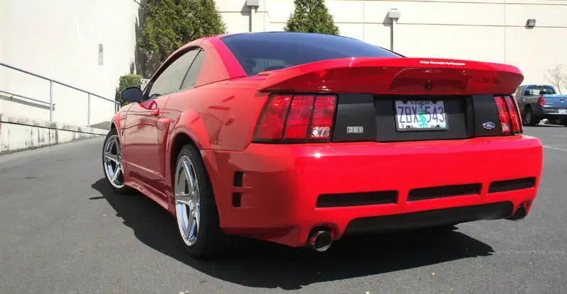

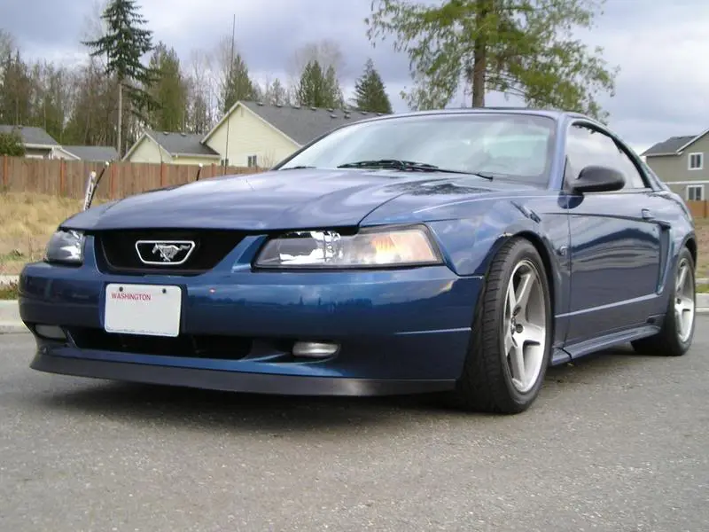

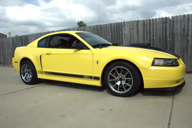

Heres whats being installed on mine.... H&R supersports-tokico shocks/struts-mm cc plates- mm bump steer kit-and polyurethane isolators.

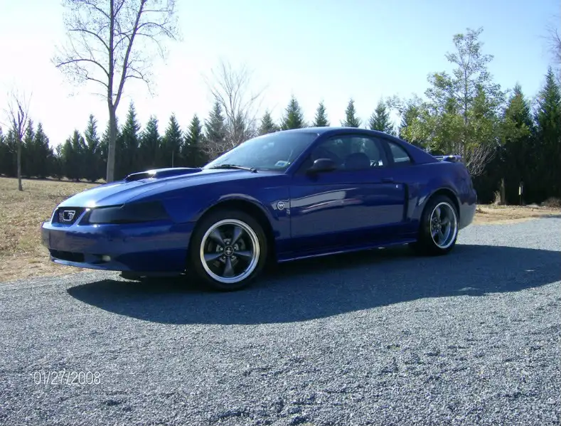

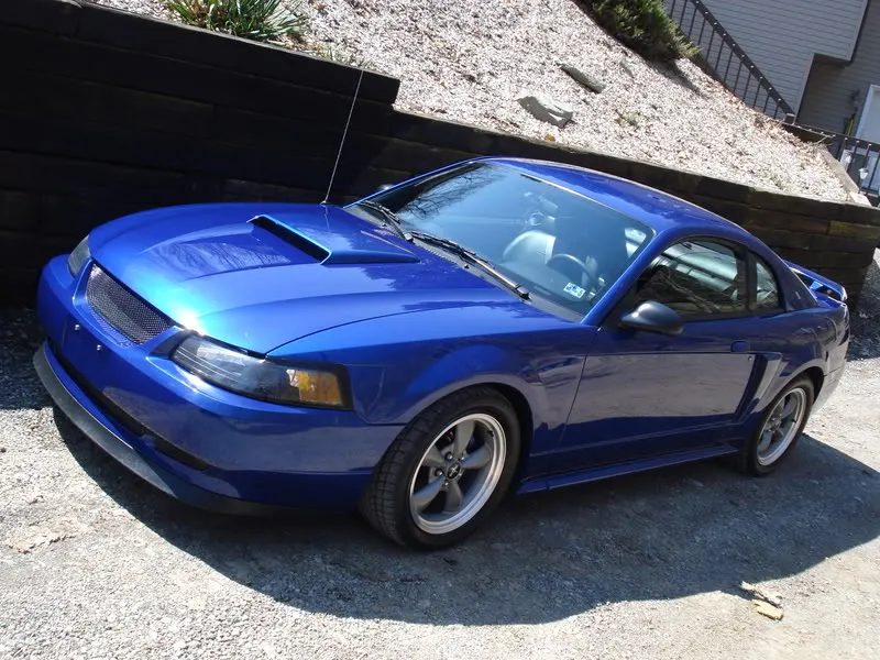

mine with a 2" drop from eibach sportlines.
after

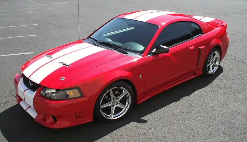

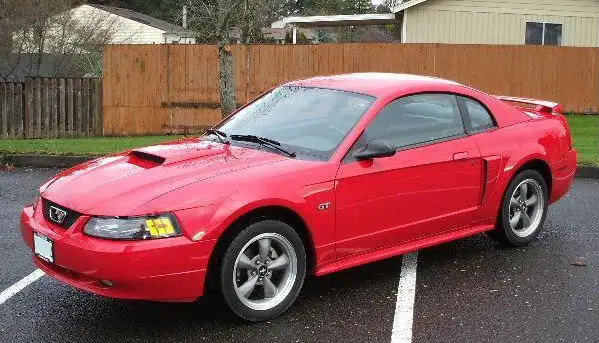

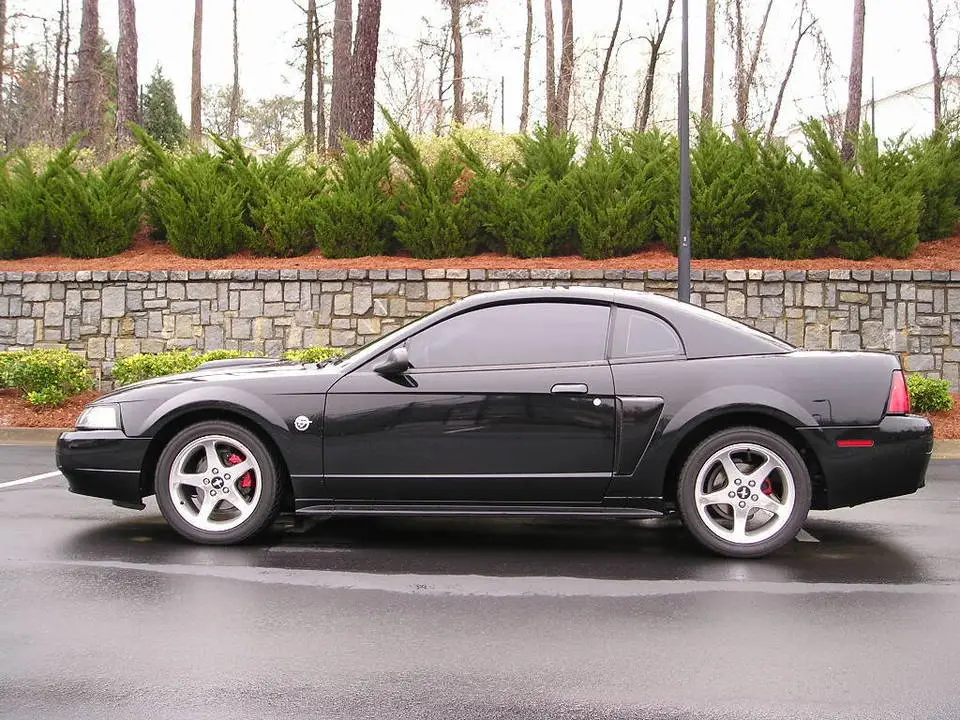

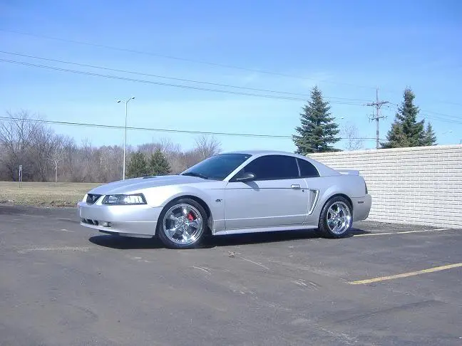

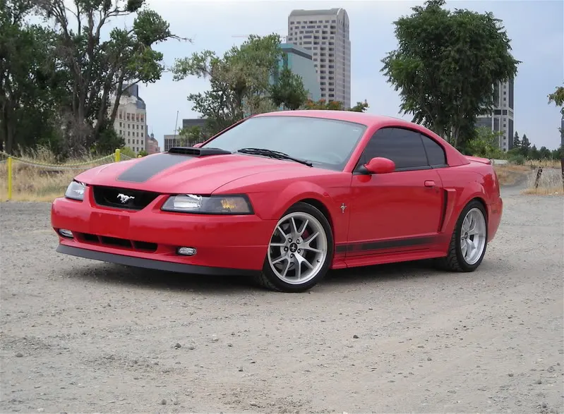

H & R SS everything else stock

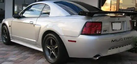

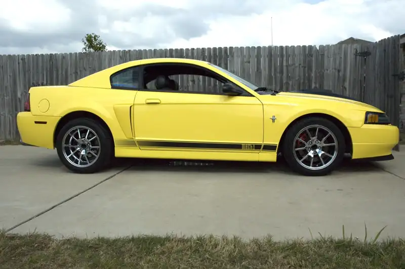

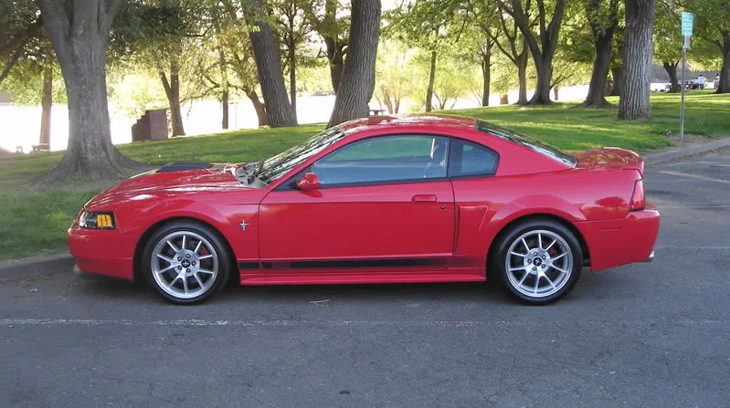

Here is a pic of my Mach when it was lowered on H&R super sports.

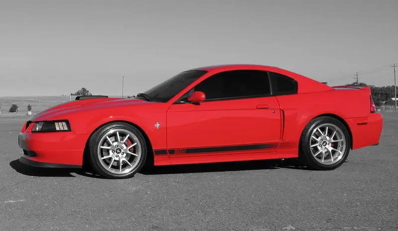

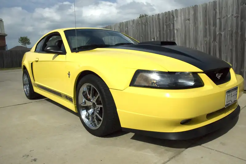

I wanted it lower, so i went with coilovers...Not sure how much its lowered now, but its a little more than 2"....
I wouldnt wanna go lower than 2 inches,I like the latter pics but There are just to many dips and speed bumps in my area that would be too much,now the first pic is nice but maybe in between your 2.So I guess I would need the H&R's.

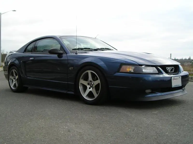

Sportlines on the front no isos. May or may not swap in the rears, its kinda growing on me and at least this way I can get over a speed bump with a very minor scape on the midpipe. I am kinda afraid what would happen if I tried to cross one with the rear dropped.
