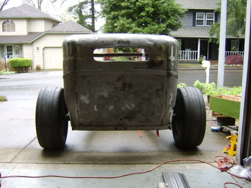

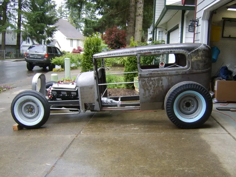

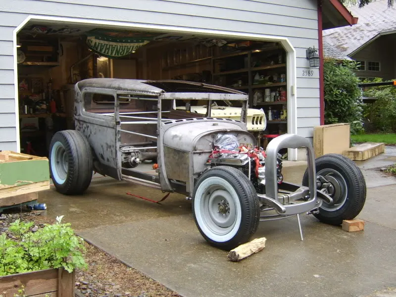

I am helping my brother hot rod a '29 Ford Tudor... Chopped 5.5 inches, channeled 4.5 inches, z'd frame, ford nine inch rear, (SBC 383)... Coming along nicely...
Like mentioned earlier LOTS of parts availability... He got the body for $800...
