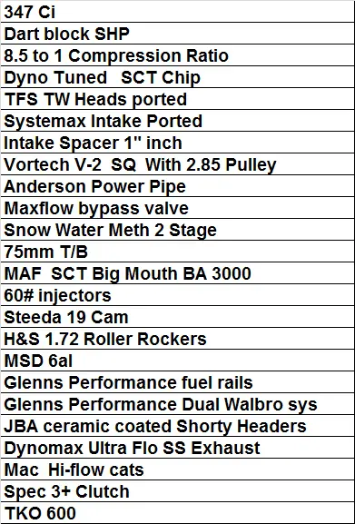

Guess I need to add this: Pops Fun Blown with 623rwhp
