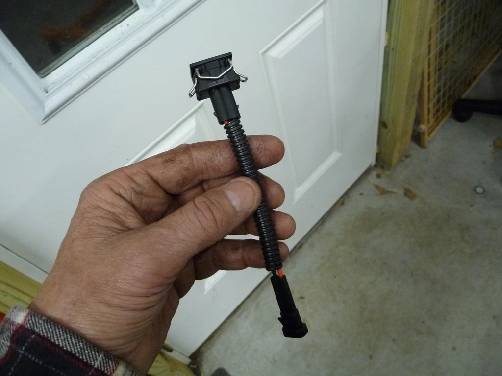

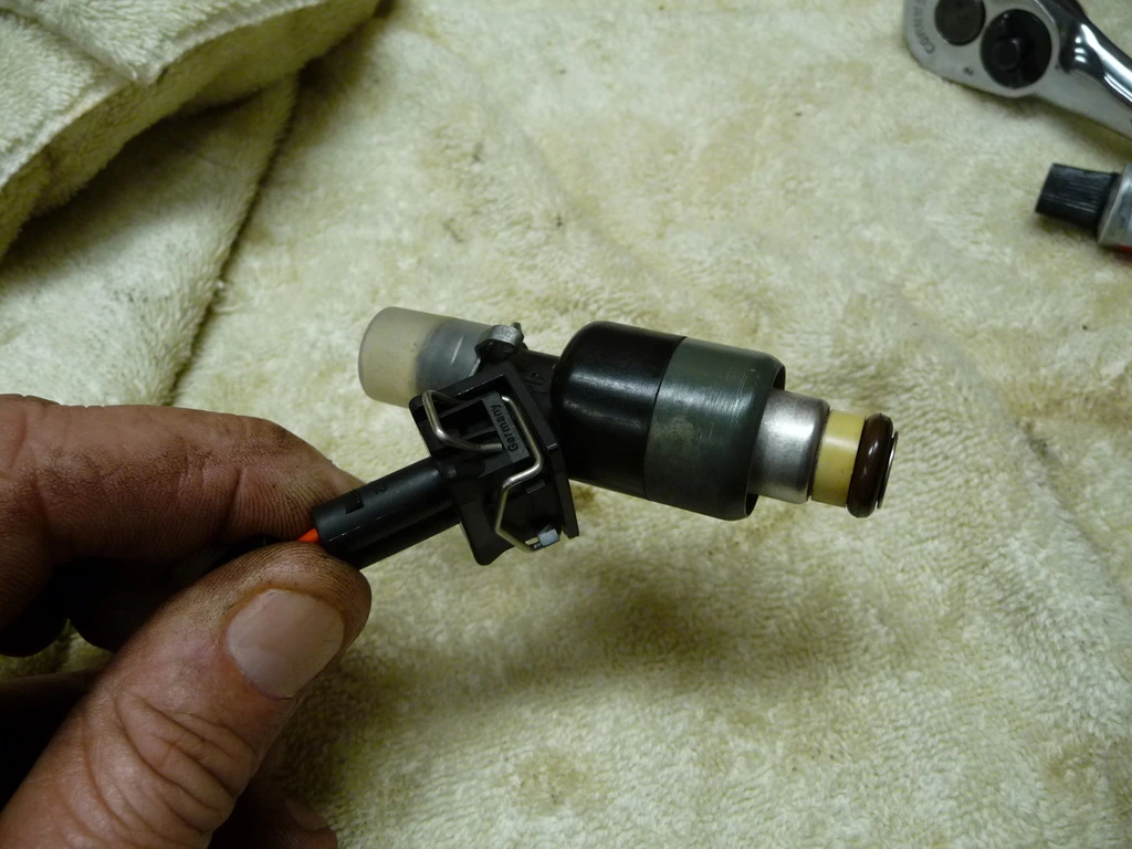

Some of my EFI harness plugs have broken retainer tabs. They also don't snap on very secure. Might even be loose enough the cause missed pulses. With a blower application I surely don't want that. I found these on Amazon and they are very good quality, made in Germany. They are made for people who want to retrofit different types of injectors onto their cars. I'm going to cut off the side I don't need and splice them on to my existing harness.

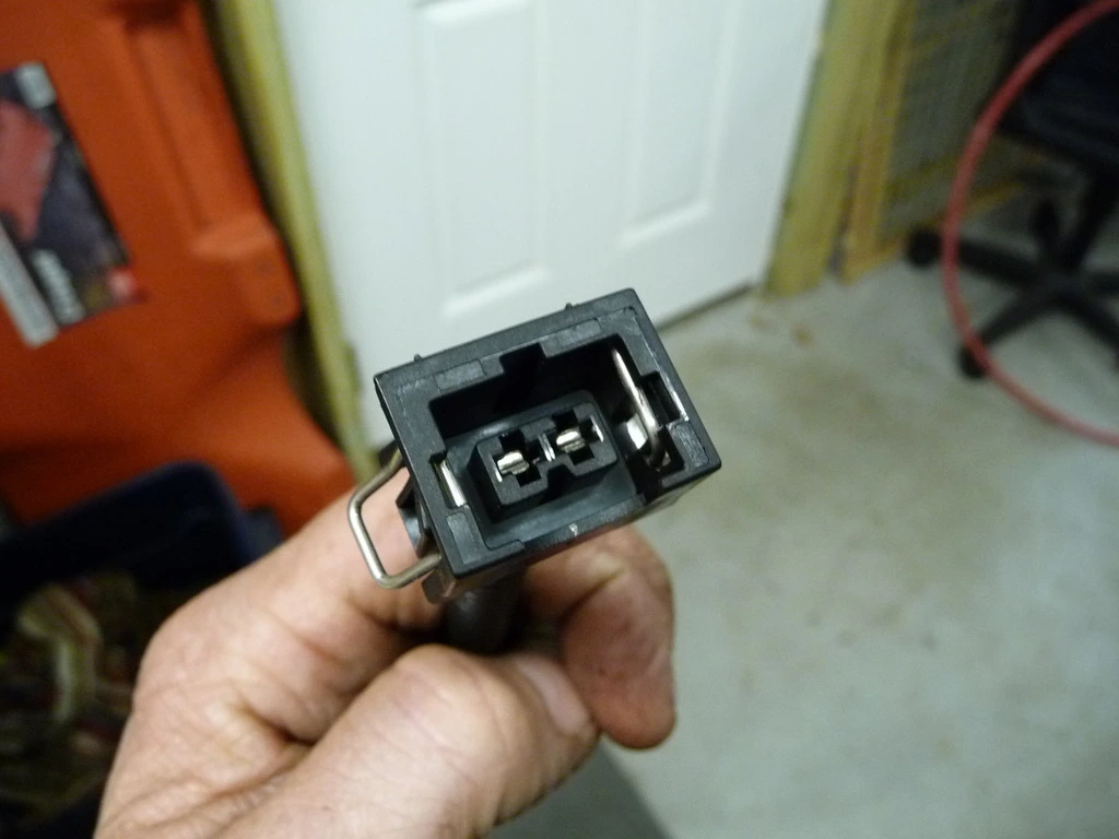

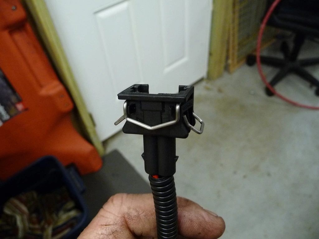

Here are some pics.
They have nice metal retainer wires that are great at securing. It's really easy to unhook as you just compress the wires in at the sides to unlock.
Snapped onto an injector
Here's the full unit as purchased. The bottom part in the pic is for attaching to the other type harness. I'll just cut that part off.

Right but I'm concerned about the connection with my stock plugs even when they are down in position. Man they are loose! So loose if you could turn it upside down they would fall off with gravity!
