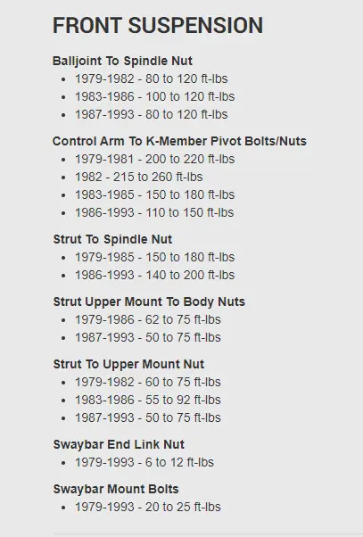

By any chance do you know what the torque spec roughly should be for those bolts?
Taken from here
