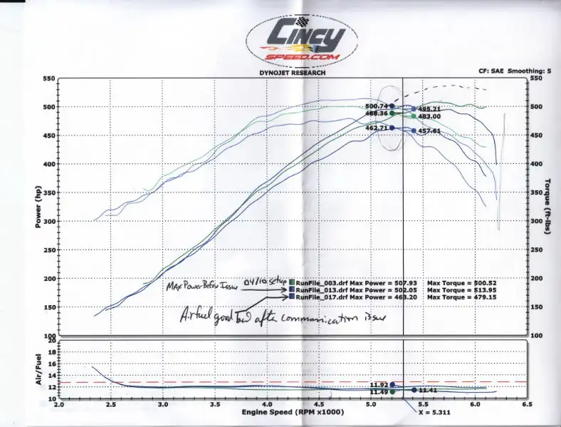

Had some trouble at the tuners... may have lost my computer or there system had problems... but
The 3 runs on here are:
03 Green an old run from last year
13 the last god run before the problem at 16 or 18 degrees timing.
17 after communication problem and just before we quit.
dotted line nothing just what we thought should be happening
As you can see the power falls off around 5300 rpm,,, ideas ??

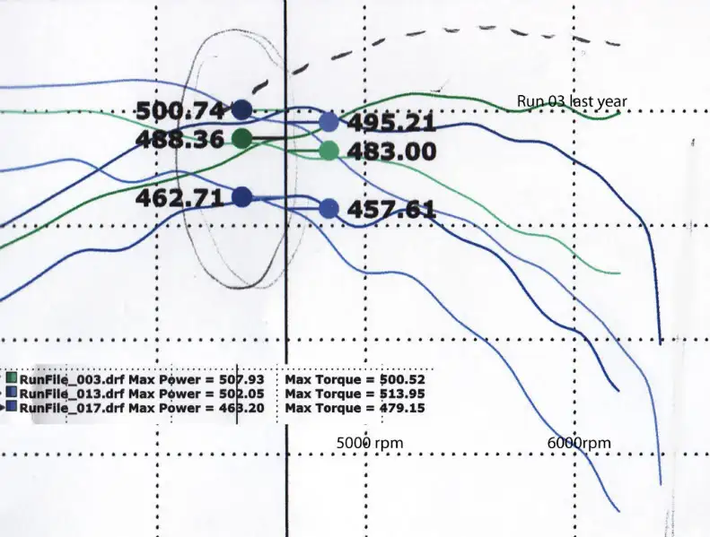

Close up of area

Even with forced induction, there is still a limit to how much air you can force through it. My bet is that the intake is holding you back. If you put on something like a SysteMax or RPM II, I bet your power will increase.
How much back pressure (aka boost) was it showing? As I'm sure you know, the better the engine flows (ie - the fewer restrictions), the harder it will be to get back pressure, and you will make more power with a lower number on the boost gauge.

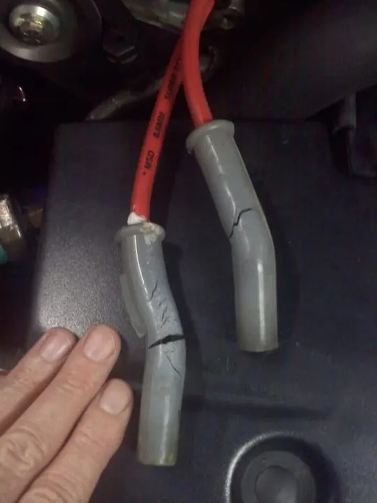

Did find this.. :( Don't know if it happen when I pulled them off or what. They got really hot..... notice the melted # ring..
New wires and plugs last night!!
