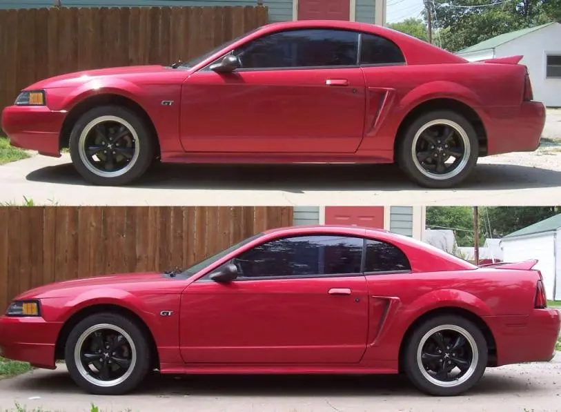

About 4 years ago, I had the hr sport springs and didnt drop the front as much as Id thought, even after a month. I was upset about it at first, but I eventually just went to a drag type suspension which was way better. Gotta get the super sport for the best drop IMHO.
I have H&R Sport. I put in new urethane isolator as well. Right after the install, the front was dropped 1.5 and the rear was 1.4; went to get an alignment a week later and I remeasured. 1.6 front and 1.5 rear. Exactly as advertised. H&R aren't suppose to settle, the extra .1 in drop that i got a week later was due to the urethane isolators settling down.
Lower quality springs will settle after two weeks because they are not manuafactured correctly/in the best possible manner. Those compnanies realize this and they just compansate for it by advertising with the anticipated settling of their spring.
One thing I could think of that is keeping you from the proper drop is maybe you didn't rotate the front springs correctly into the slot/groove on the front control arms.
My Sports only gave me about a .8" drop. They never settled. People tell me, still to this day, that I should lower my car. I tell them I did. I had a slammed 5.0 and it got annoying. I don't like rubbing tires on my fenderwells, and scraping but I wish I had got the Super Sports. But I'm happy with my setup. The 18" rims helps a little too.
DerekStangGT said:
btw, what do you think about the Bilstein Shocks/Struts? stiff? how do they handle?
I haven't done the rear yet, due to the fact that the (wrong) diagnosis was the front struts. And I want to pay off the front half first.
But, I am quite pleased with the ride. It's not at all harsher than I was used to on my 100k stock suspension. (Could be different than new stock.) In fact, the stock rear feels out of control over parking lot bumps. If you're used to the Mustang suspension, then the Bilstein struts will not be a harsh surprise.
I'm fixing to dig through my trash to find my stock upper isolators. The drop is noticeable, but not what I waited 6 yrs for.
-Travis
2k GT

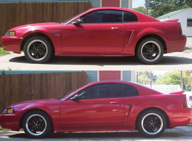

GDawg said:
My urethane isolators took away 1/4" of the drop. H&Rs are not supposed to settle but I think they do. Give it a month and then let us know. H&Rs rock! :nice:
I swapped out the urethane isolators for stock, but that didn't help much. I decided to cut them, but couldn't do it with my hacksaw, so the stock springs went back in for two days w/out any isolators. BTW, in two days time I did experience noise over RR tracks w/out isolators.
I measured the cut to give me exactly the drop advertised, but apparently w/progressive springs, it is not a 1:1 ratio. So I actually ended up with a 2" drop in the front instead of 1 5/8". It looks great, though.
Forgive the horrible pic quality, but here is the before and final cut installation pics.
