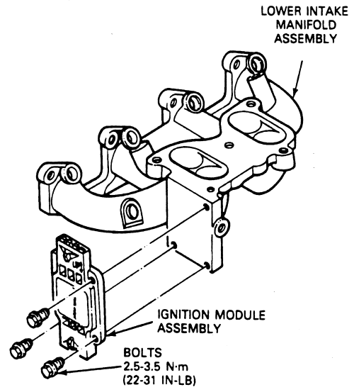

Sounds like a bad ICM (Ignition control module). Its located in the lower intake manifold, should be around $100 to replace.
Thanks to everyone, I think Dan P is on to something though with the ICM I remember replacing it a few years back and now that I think of it I think it is running similar to how it was when it needed to be replaced. Anyone have a brand to go with last time I just picked up the part from autozone and seems like everything I get from there needs replacing again.
