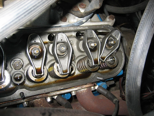

I just got finished swapping out my cam and I got interrupted when I was adjusting the #7 and #8 intake rockers - never finished setting them up. When I started the car I had a knocking noise that I thought was a torque convertor bolt lightly hitting on the separator plate (it's a tad bent up).
Still had the noise after making sure the convertor bolts were straight. After taking the car for an easy drive the noise immediately stopped and I knew what it was.
Popped the valve cover and the two rockers were off the pushrods. In the pic I had already loosed #7 and put it back on. #8 was how I found it.
I pulled both pushrods and rolled them on a plate of glass - they are both perfectly straight.
I readjusted the valves (properly this time) and took it for a drive - all is well.
My only fear is that the lifters may have somehow gotten messed up when the pushrod got pushed in offcenter.
I would say the moral of this story is to double check all your work but I actually did the valves twice when the engine was out of the car just to be sure everything was correct - I got interrupted on the last two intake rockers and never tightened them down.

been there, done that... difference being it happened to me at about 6000 rpm, and the lifter jumped out of its bore. btw, i wouldnt worry about the lifter too much

Did a lower intake manifold change on a newer buick and nearly did the same thing, except I had the pedestal rocker on perfect, the pushrod however was not seated in the rocker. I started it up and I thought I threw a rod

I had the same thing happen to me in the 90, weird thing was that I had been driving it for months without a problem.
Then one time I passed someone on the highway, and heard a bad tapping, the car was running like crap.
So I pulled over and took the upper intake and the valve cover off real quick (yes, I've done it way too many times, I'm scary fast at this) and I saw that the #3 intake rocker looked EXACTLY like the one in your pic. The bolt was really loose. I just made sure the pushrod was still straight, put it all back together and haven't had a problem since. That was about 3 months ago.
