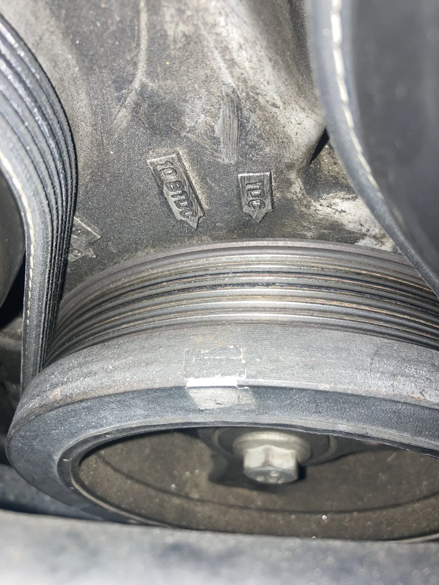

Do you know how to tell if the harmonic balancer has slipped? Here is a photo i took...
If you can do it yourself replace your balancer. It's probably in need anyway. I touched mine gently on the side while idling and could feel it. Plus you could look down and possibly see it off. A little off is a lot off. My car was much better after a fresh one.

After the in-depth description, it’s something from the clutch forward.
The balancer is a likely suspect. Too bad there is not a cylinder balance test like OBD1.
