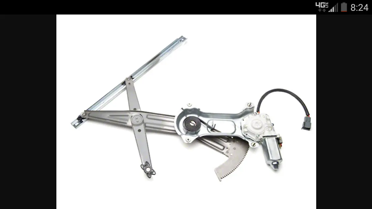

Hi guys, I got 95 GT1 coupe.....no convertable. I have to pull up on my drivers window as I push the window switch to the up position to get the window to close. I hear the motor but it won't lift the window. I have a new window motor but the Haynes manual said if the secter gear isnt locked into place with the backing plate (by putting a bolt and nut thru them and screwing them together) and the motor or counter balance is removed it can cause serious damage. I don't want to break the window or break my fingers replacing the motor. The manual don't show or explain where the sector gear or backing plate are. Does anyone know where I can find an exploded view of the inside of the driver door labeling said parts? A picture that labels them, hell I'll even be happy with a crayon drawing from a 5th grader if it'll label the parts clearly! Lol Thanks
If you don't put something to hold the window mechanism you could....loose a finger. See...the mechanism is spring loaded ( note spiral spring ). I haven't done one in a while bit I used to stick a screw driver through a hole in the door and into one of the holes at the " x " to lock the arms from moving. That way the serrated teeth and sharp edges on that thing didn't try to chop my fingers off. @akaNYr
The motor is holding the tension on that assembly. In the full up position " I think " it has the least tension on it and the motor can be removed.

I have rivets holding my motor and regulator in place, do I just drill them out? What size nut and bolt do I replace the rivets with?
