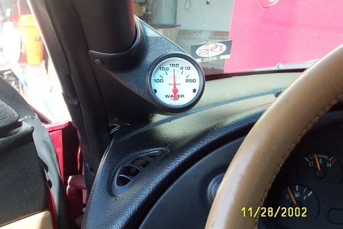

I understand about wanting it stock, but the Autometer gauge is way more accurate, and you can get a single A-PIllar pod to put it on. Dont worry about exterior cosmetics when buying it, unless there is "structural" or "frame" damage. Clutches go anyway....Make an offer and go from there!

Could you post a picture of the autometer gauge in your car or just what it looks like in general. And also how much did you get yours for?
Here you go....you can see in the pic the stock one still works, and where 180* lies on the stock gauge.
attachment.php
I didnt get anything for mine...I still have it! :D
But Summit gets I think $40/$50 or so. Then you need the Pod, which is about $20. I have a single pod lying around here still, I think
RC
